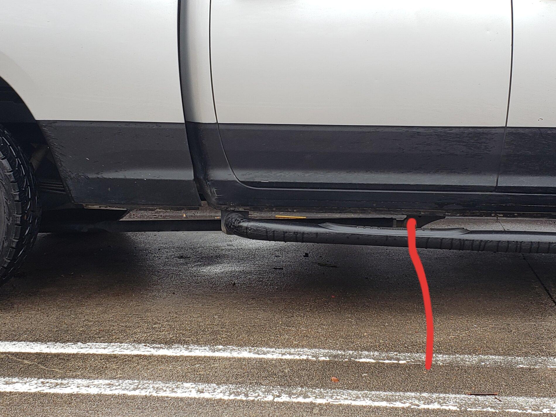

Pretty sure mine might be too long. They re 72" and the brackets are from axle to frame and stop just shy of the farthest rear part of the front doors. Almost even with the front of the rear doors both sides.
I haven't noticed any real binding but I don't off road and they don't pop ever. I'm thinking it's just extra NVH
Thats pretty long, being stock height helps a little since the traction bars are a flatter angle then a lifted truck but will bet there is still some binding going on there as the leafs move.

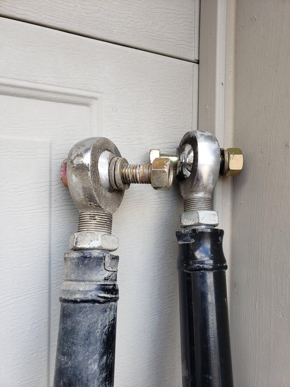

Alright, so i pulled the bars off. definitely the reason for the added road noise into the Cab. I am going to see if i can find some rubber spacers to use between the hardware. Might have to go down a bolt size as these current bolts are a 28mm socket size and grade 8 gold. They are very hefty bolts.
I am also going to see if i can find someone that sells shackle kits so i can add them on. I connected the makers of theses style and they told me with there setup shackles arent needed but I think you guys might be right that they are maybe binding some.
Shackles are worth a try, very few companies have actually done the R&D to make the bind as minimal as possible, there will always be alittle due to the path of how leaf springs move, but that is why I run Patton fab bars. They are the correct length and geometry so even with having 13.5" of rear travel I dont notice any bind and the joints use poly races so no NVH is transmitted but they are expensive.
Be careful with such large bolts, I know someone who had a very similar setup to yours other then his truck saw a lot of hard off road use but it actually ripped the mounts right out of the frame and they were welded in well. I doubt you would have that issue just on road but if there is a bind it will find the weak spot eventually.
Yeah i've looked at those bars and they look like they would work great. I also agree that the hardware for these bars are massive. I am trying to get a picture loaded so you can hopefully see but I am pretty sure they are 3/4" thick at least.
The bars themselves weight 40-50lbs a piece easily.

1. Go to my local Elliot's and try to find bushings and go with a half size smaller on the bolts to eliminate the NVH noises to the cab. - You could also look into a Poly joint like these - https://www.ballisticfabrication.co...bushings/products/forged-poly-bushing-1-75-od
2. Sell the traction bars and save up for something different. Ill need to find another welder at that point. - Probably the best long term solution but not cheap.
3. just get rid of them all together? - Depends if they make a difference, I never had alot of axle wrap or wheel hop but the rear end does feel alot more planted with the traction bars and there is zero wheel hop or axle wrap which is nice.
trying to decide is hard cause when it comes to my truck i can never really make up my mind lol.
Well there would still be some binding as the geometry is not correct but the Poly will be able to deflect and absorb the bind where the heims arent doing any of that.
