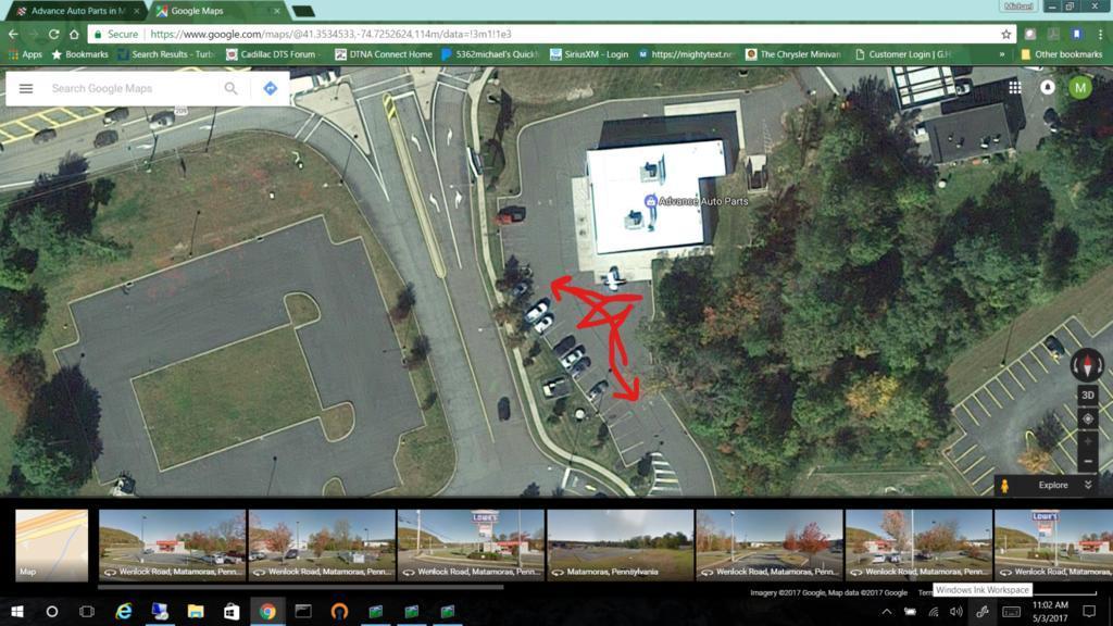

Had to make an emergency stop at an Advance Auto in Matamoras Pa coming home and I turned it all around in an automotive size parking lot with no issues or dents. 3 jigs and I was turned around....
One scenario where you might get screwed would be a narrow campground road with a 90 degree turn into the site which has a Pine Tree right at the front left corner...
I turned the Megacab and the 33' trailer around here with cars in the parking lot as shown with no damage. You will not be in such a situation as a rule...
