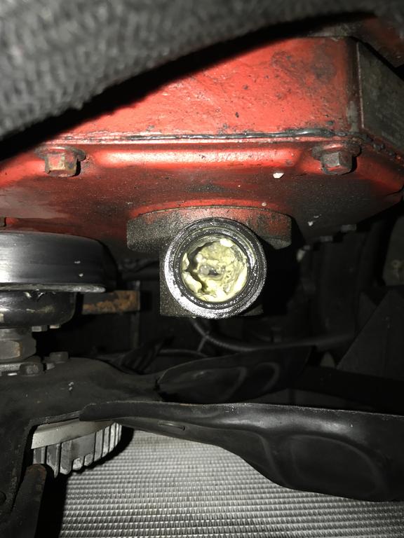

I have this slime like stuff that comes from the blow by tube and leaves a pile under my truck every night. Almost like snot consistency. Looks brown on the ground then when I pick it up move it around in my hand it goes away. Any idea what this is? 97 3500 dually automatic. 66mm turbo, 80 hp injectors, honed head, head studs. All have 6k miles on it

Here is what the inside looks like. Hasn't been like this long. The truck runs pretty decent too.

I've put about 4K miles on it since I've had it. This slime like stuff showed up one day then has gradually got worse. Like it leaves piles on the concrete. The reason for the rebuild was it spun a bearing. Oil is clean with no water/antifreeze in it. The radiator has no oil in it but I do loose about a gallon of water/ antifreeze every 5-7 days. Truck runs great hitting 35-40 psi easily but really scared of why it has so much blow by and this slime like stuff. It's even under the valve covers.

I did not check for bubbles in the radiator. I called the shop who did the work on the truck and they told me that when they did everything they put the original head gasket back on. Then they put the bigger turbo on later so they did not want to take the head back off and just rolled with it. I also noticed some antifreeze on the bell housing. Reached around to see if the freeze plug was busted but didn't feel like it. Shop said it's more than likely a head gasket so I guess we will see.
