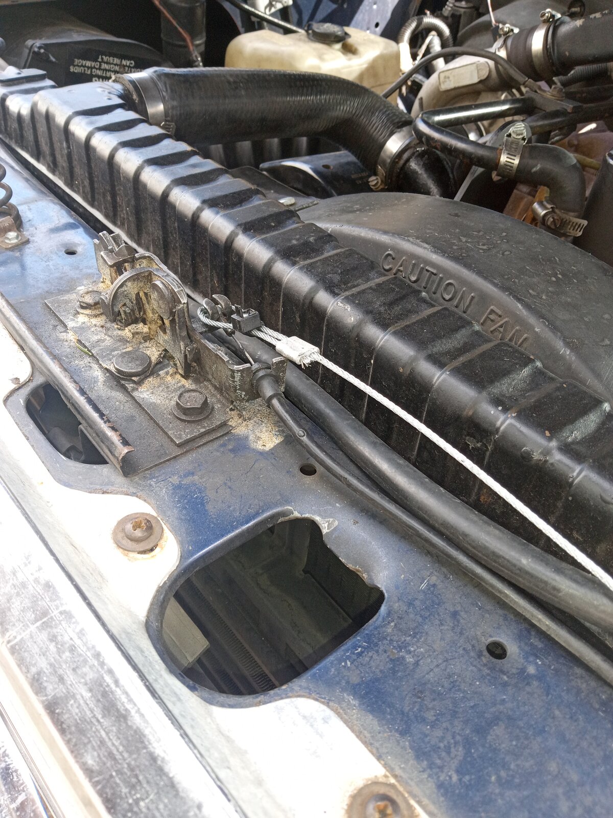

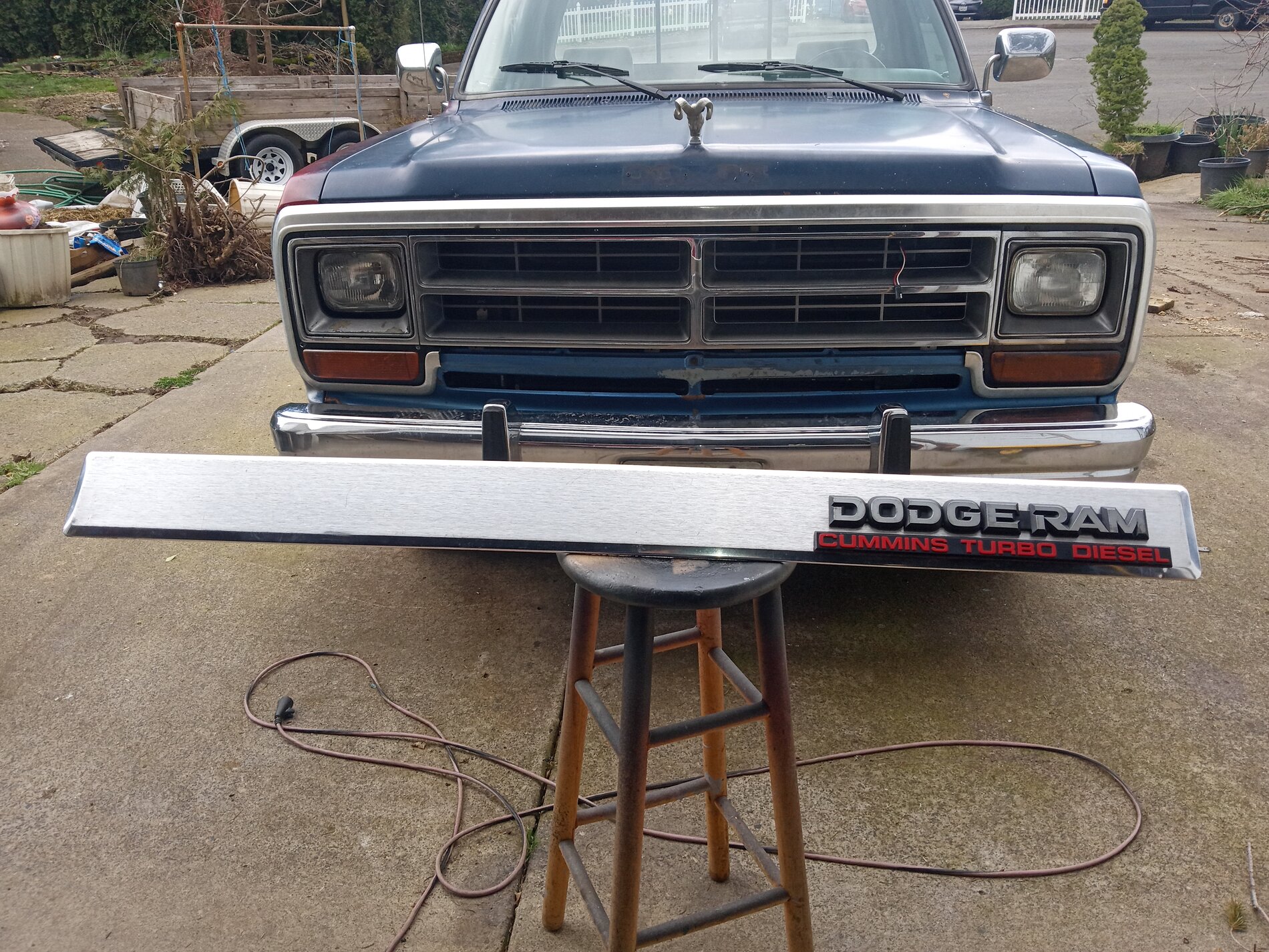

Got a few items done,still got a couple more electrical things to fix. Dual optimas. The cables connecting the two together cost me $14 shipped on eBay. NAPA wanted 70 to make them, the others I had. Emergency hood release cable thanks to you tube decent garage. Moved voltage regulators next to batteries. Put in a hookup through the grille for optima battery charger. Got my tailgate trim panel a very nice one from eBay. New carpet came the other day, won't go in till summer.
