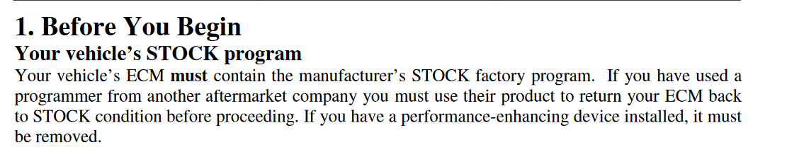

Try programming it back to stock, verify that the S06 indicates VIN unlocked.
Then program it again, even for testing I would go no higher than SW5. Torque should be set to stock above SW3 with a stock trans.

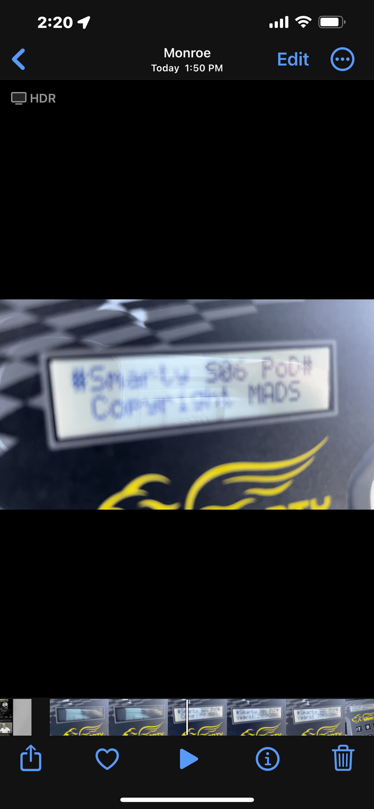

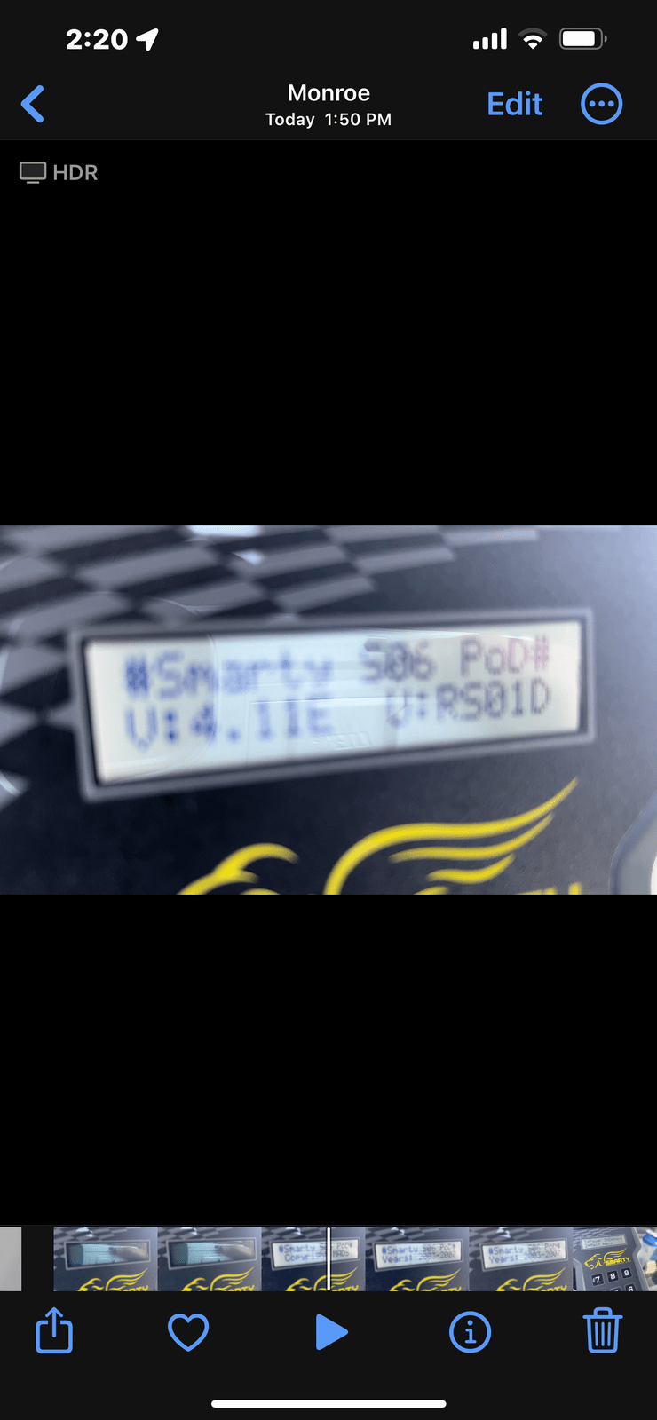

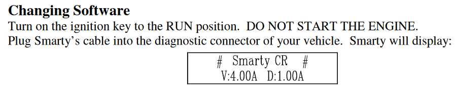

You haven't mentioned if you see the "#" symbol on each side of the upper text on the display when you perform the step below. If you do not see those symbols, the Smarty S06 is not VIN locked to your vehicle and the ECM will remain at stock performance. A this point there will be no point in selecting the parameters for a tune, as there is no communication.
Also, from the Smarty S06 instruction manual:

Check my previous post. I was having trouble uploading photos while you were replying. After switching on the ignition and plugging in the Smarty to the OBDII port, the first thing displayed is the Version Number with the "#" symbol visible on both sides, IF the Smarty S06 is VIN locked.
