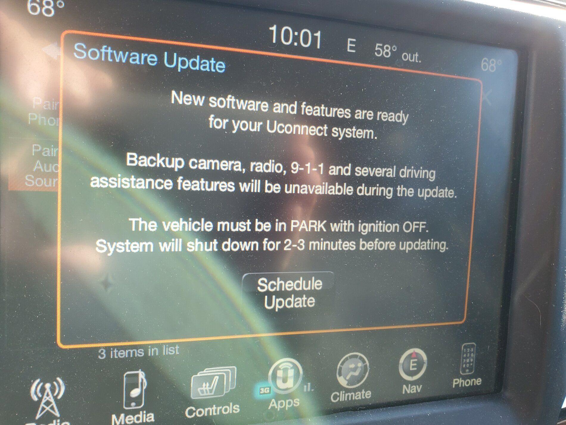

Last few days I have been getting a message about software update for Uconnect system which "needs to be scheduled to install within 24 hours". Click on "schedule update", punch in the time you want, done it 3 times now and nothing happens and I get the same message each time I start truck. It says to have in Park with ignition off at your scheduled time. The kicker is this radio assembly is replacement of the original which failed, done less than 6 months ago. Seems strange it would need an update already. BTW you dont get a NEW radio...its a refurb...very expensive repair so glad I have the Maxcare warranty...and I woukd prefer NEW parts not refurbs...

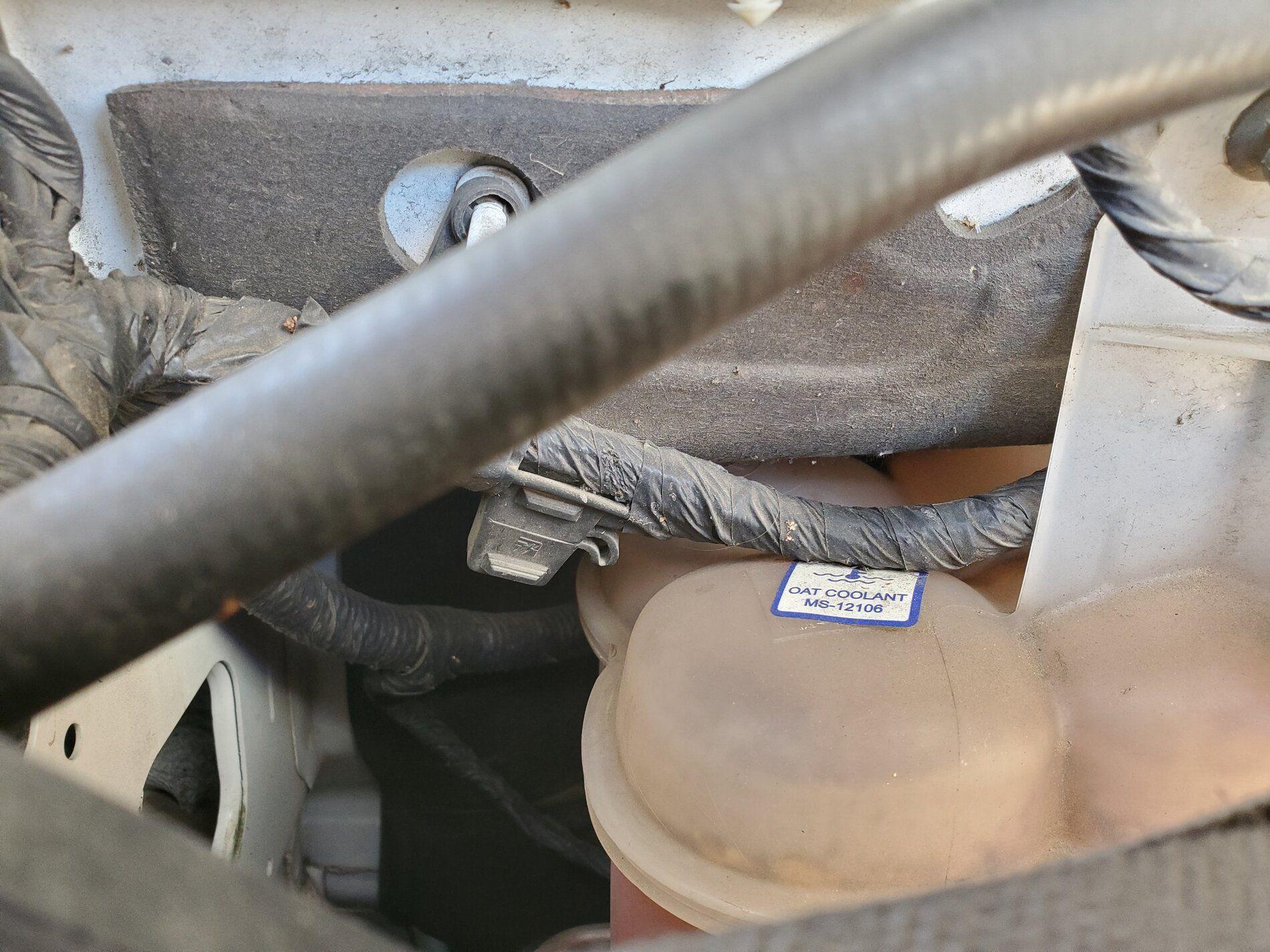

If it will not schedule pull the radio fuse for a few seconds and try again. The inline fuse is near the master cylinder or over by the coolant bottle. It is NOT in the fuse box. It might take two ignition cycles to restore the radio configuration after disconnecting the fuse.
So leave the fuse OUT for a couple or 3 ignition cycles? Circuit has to be energized with fuse out? I took it out for a minute then put it back in and still getting the same message every time I fire it up . Fuse is on passenger side on mine. Awkward to get to.
Did you schedule an install time after the reset? The idea behind the reset is to make the update happen, not delete the message.

I can't imagine why they would disable radio and NAV in the meantime. But I will try manual download. I will be really pissed if it ends up being a defective refurb radio that dealer installed a few months ago. "Can't get a new one under warranty only refurb".
So I checked my System info and found software version 18.43.01. Not sure how it differs from 18.45.01 but anyway there was a post on Ramforum by a tech who said if you are getting the update infinite loop to pull the fuse for at least 20 minutes. So I did and after a couple ignition cycles its all working again. Guess my refurb radio is FINE. Ha!
