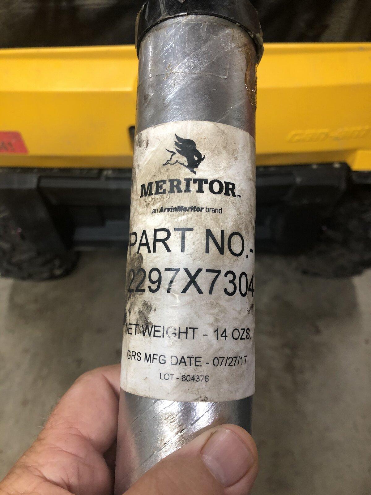

For a coating, believe it or not, the second best thing I’ve come up with, is dielectric tuneup grease. That stuff just repels water, and doesn’t really dry out like anti seize compound can. The first best stuff is a special lithium based grease that Meritor supplies with their air brake S cam service kits. This stuff is incredible. You can’t grab a tool if this stuff is on your hands. Problem is, it’s unobtainable separately. A while back I got Mike Wilson involved to try and source it, but I don’t recall even him being able to find it outside of the kit. The other big thing is to seat the boots properly, and don’t rip them.

I did find the Meritor grease.
Wayne, you don’t remember me *****in about the price??:D
Around $28.00 per tube but it does seem to work pretty good!! Plus it will last a long time..

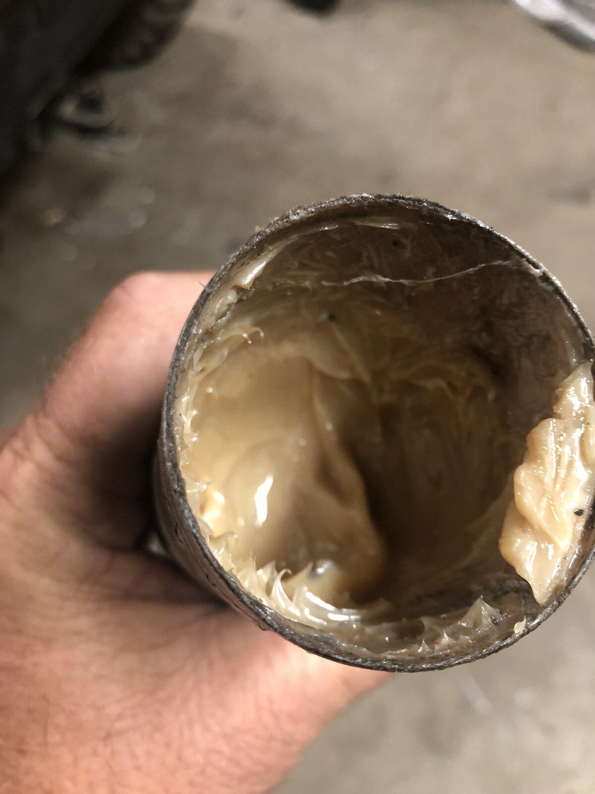

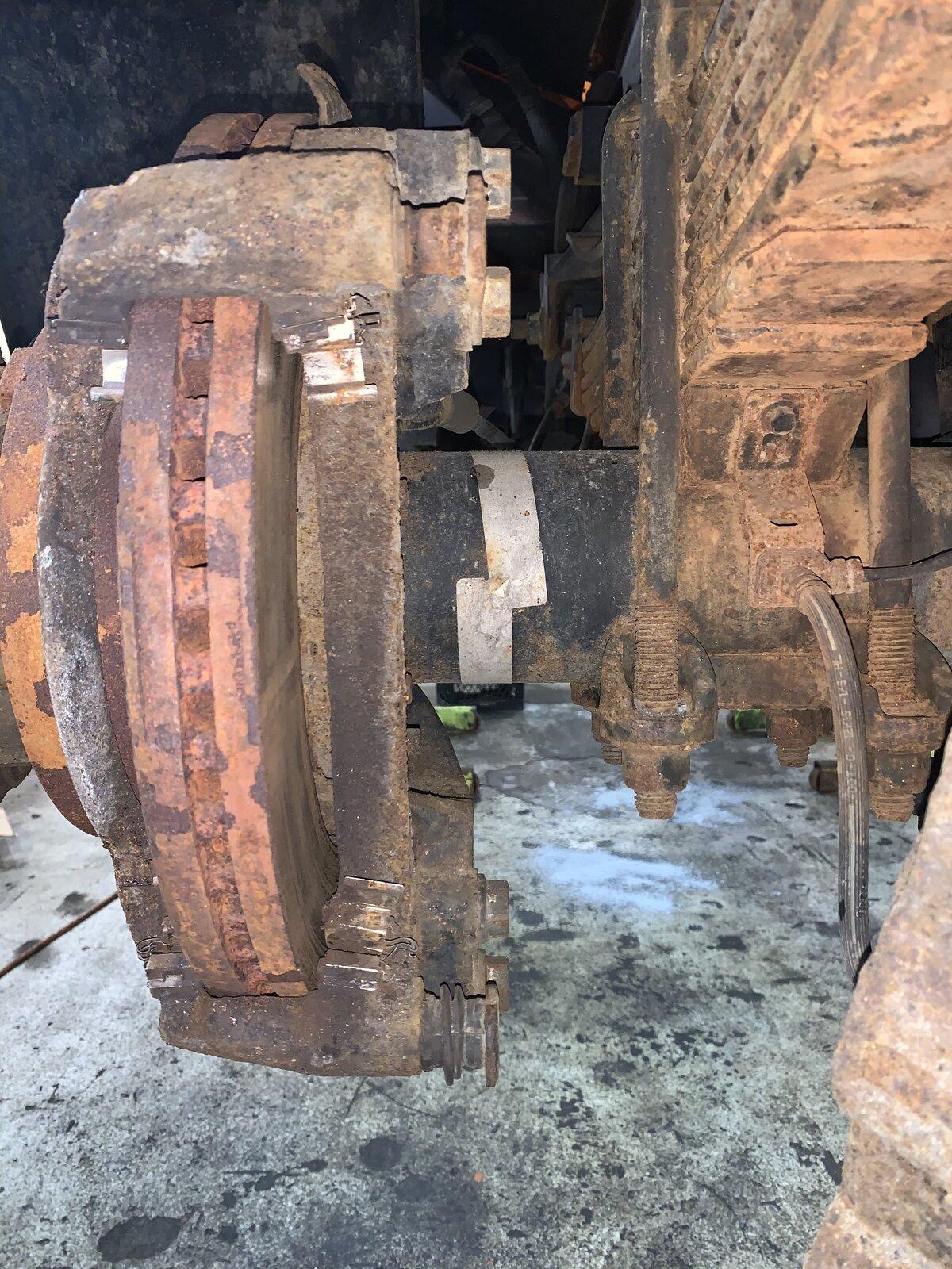

Anyway I started another one today. This is a ‘17 F550 and on these, they went to a pin in hole in the bracket deal like we see on passenger cars. It’s even worse. This has been together for one year and the boots are intact and seated. I ripped out one boot to show the carnage. I wasn’t the one who did it last year so I don’t know what lube was used, but both these pins are seized. Off comes the bracket and to the torch.
It’ll go back together with that Meritor grease.
