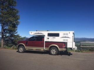

As I slowly optimize my truck for camper use and mild off-roading, my next big project is to move the spare up front. I hope to accomplish 2 things - 1) make the spare easily accessible with the camper on. And 2), move a few pounds from behind the rear axle to up front to help with weight and balance. Some trips I may even take a 2nd spare.
You can see accessing the spare in any sort of off-pavement situation would be a hassle...and I haven't even figured out how to run the tire winch with the camper on...

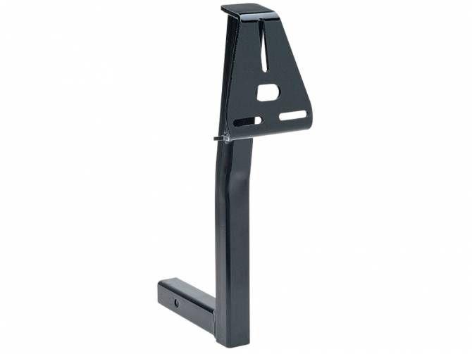

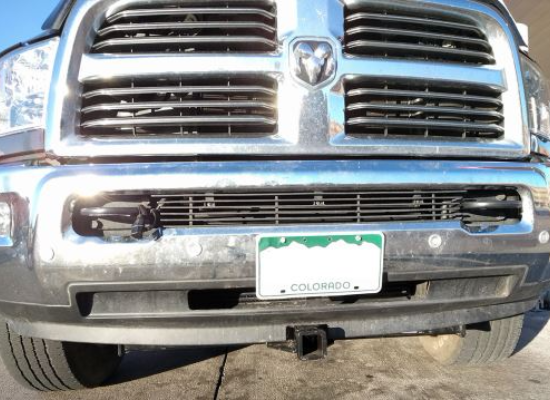

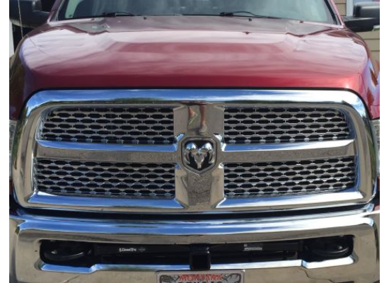

Drawtite/Reese 65063 - about $140-$150 - mounts behind the tow hooks. I was worried about blocking air flow to the intercooler, but can't find any reported issues of problems. I also like the small amount of protection it gives the intercooler.

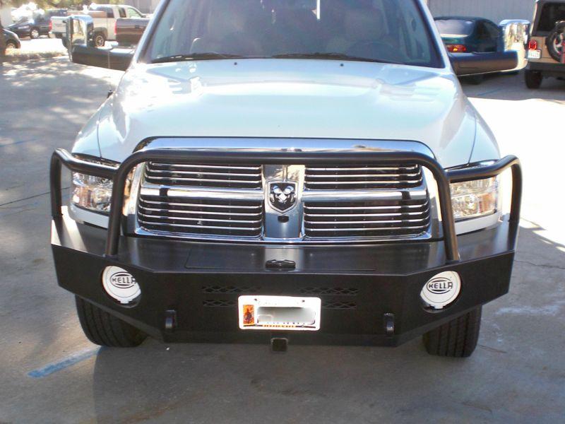

This was a custom job - picture I've had for a while from somewhere on the internet. I love this solution but not commercially available as far as I know. I wonder what a custom shop would charge to do this?

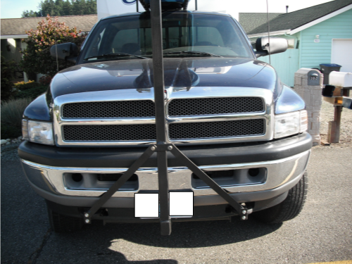

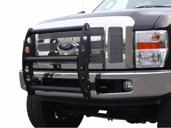

Picture this without the bumper part,use you stock bumper,and without the headlight protectors.I had something like that made in the 70's,it had a place to mount the spare right on the middle bar and a padlock to keep the honest folks honest.I did not lose any ground clearance and I did not have any overheating issues.
I just found this,mine was very heavy duty,but this is what I was trying to describe.

My other consideration, after the receiver, is how to actually carry the tire. There are a number of different variations of this out there - between $75 and $150. While its just a solid chunk of metal, I'd love to come up with a 2 point mounting system to avoid teeter-totter movement bouncing up and down. Between this (20 lbs), the tire (50 lbs), and the wheel (~30?) I'm guessing that's a hundred pounds +.

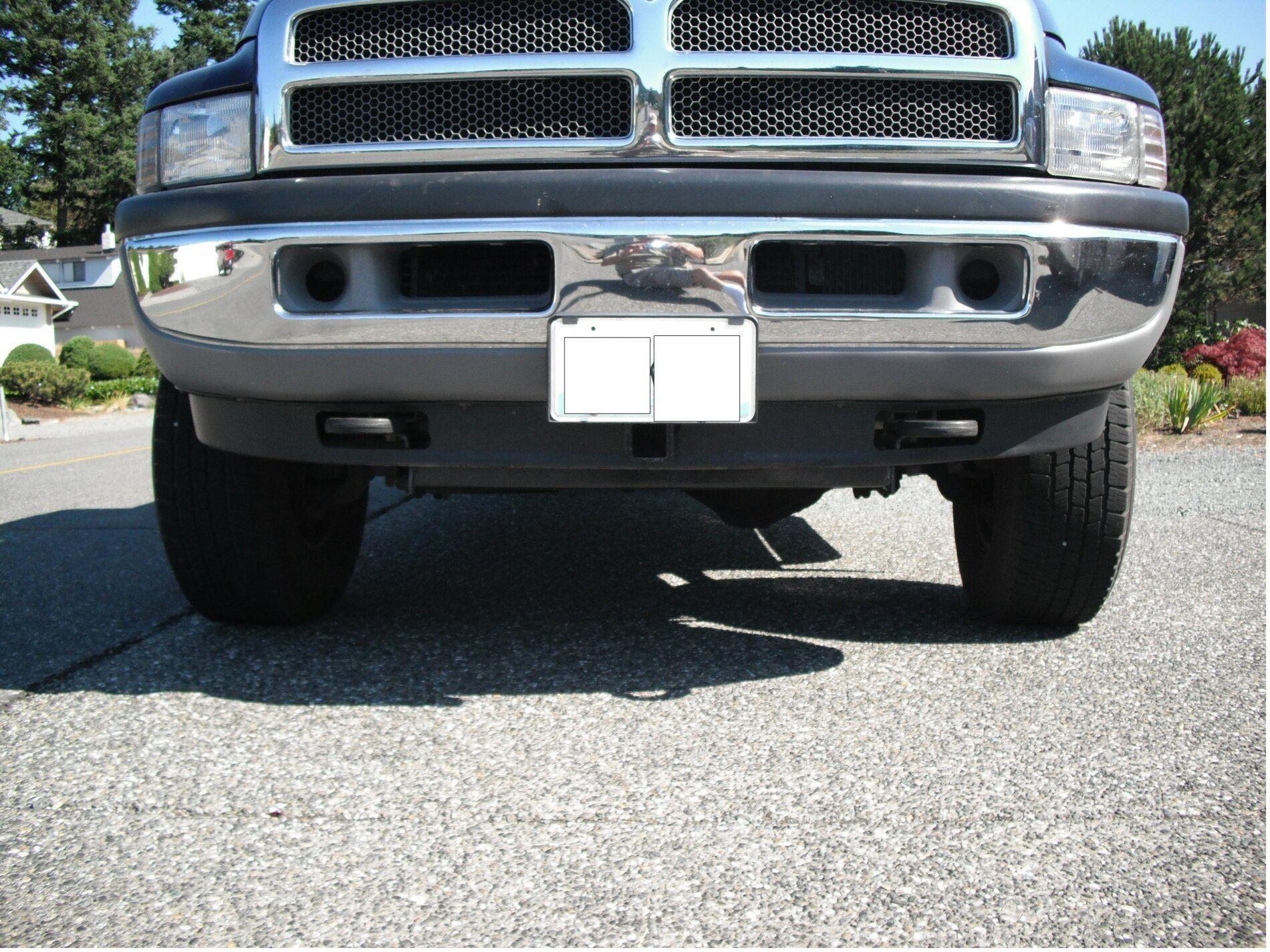

Wild thought, would you be able to mount 2 small custom 1 1/4" (class 2) receivers just inside and under the tow hooks? Then make a mount that would connect to both receivers? That way you could keep the charge cooler intake clear most of the time, then have stability when you do mount it. The mount would be a little forward of the intake area allowing air to enter.

I have the tow hook type front receiver and haven't noticed any cooling difference. Look how's much the aluminum bumper covers, a bunch. I'm on the east coast- mid Atlantic the desert may be a different story but I doubt it.

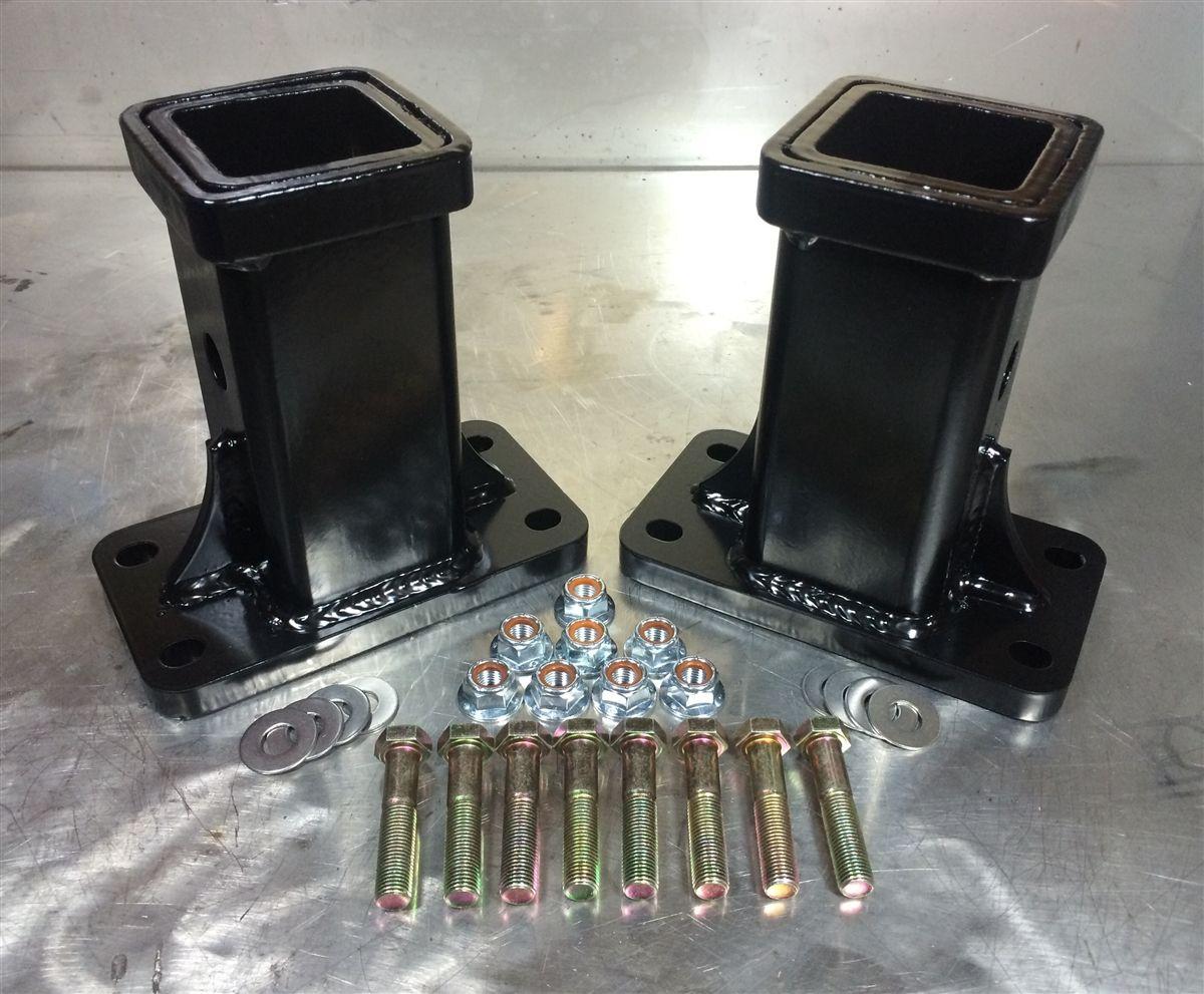

I was almost ready to pull the trigger on the drawtite/ pole mount option when I came across a set of very high quality tow hook replacement 2# receivers. They are actually a little more expensive than the drawtite mount, but I like the ability to go with option 3 above and see if I can get someone local to fab up the actual tire mount. Was thinking of keeping it simple and using 2 ball mounts, upside down, in those receivers and then a cross bar for the tire itself.
Thinking of a set of these
or maybe these - quite a bit cheaper, but no reinforcement
The reinforced set is about a Ben Franklin more, but I am thinking with the side reinforcement they might be useful in some other applications as well, such as a receiver mounted winch, etc.

While I like the invisibility of the Drawtite front hitch mount when nothing is attached, I think that a single post mounted spare mounted attached to it would drive me crazy rattling around as I drove. Even with using an "anti rattle hitch pin", I think there is too much weight at then end of a long lever for that to help much at all. SO all that being said, I like your idea of using a custom made tire holder that is almost triangulated (built like the letter "A") down to the tow hook replacement receivers is a better way to go. I would definitely use the reinforced models if the reinforcement is of decent quality and not simply a tin plate.

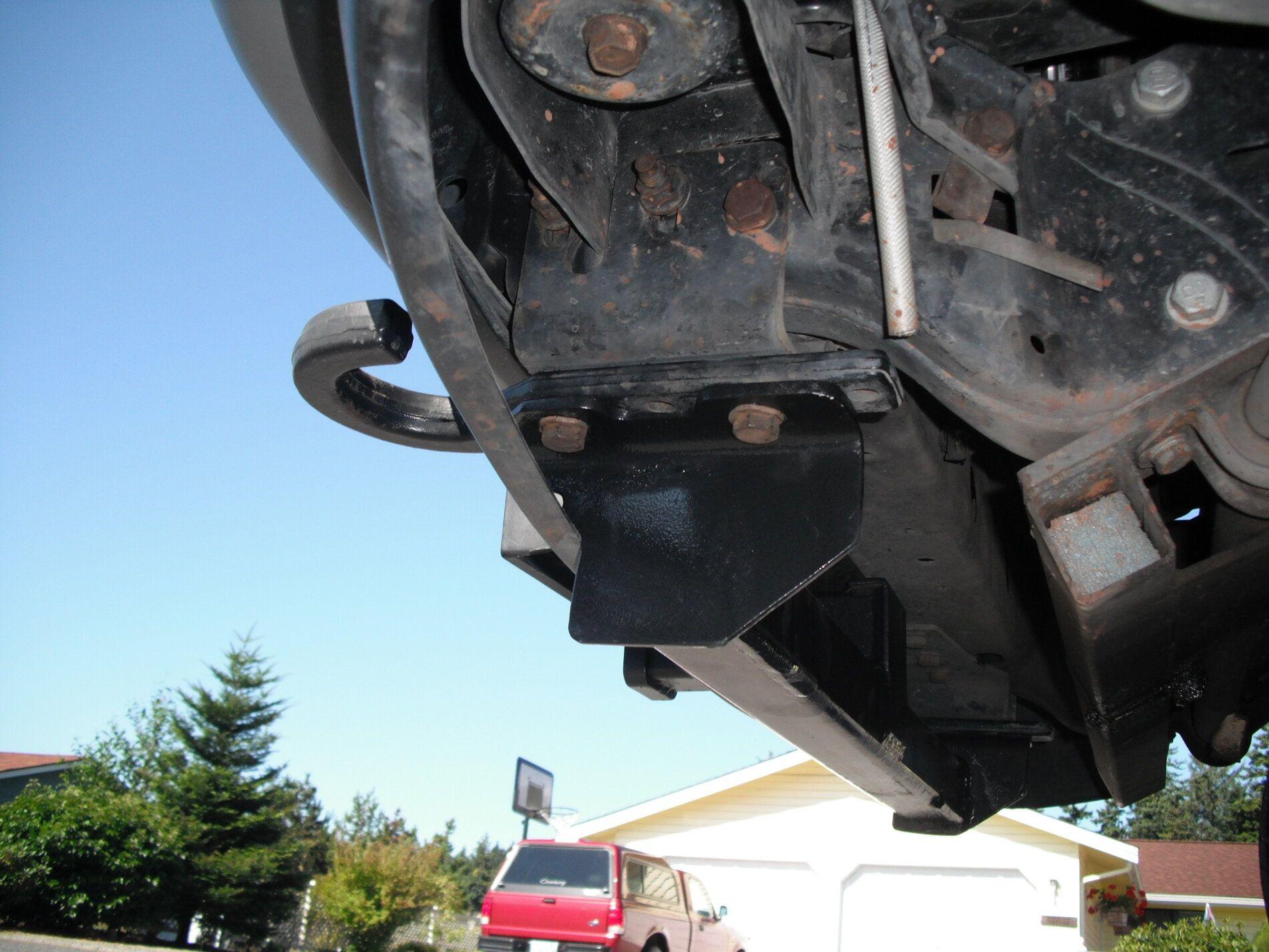

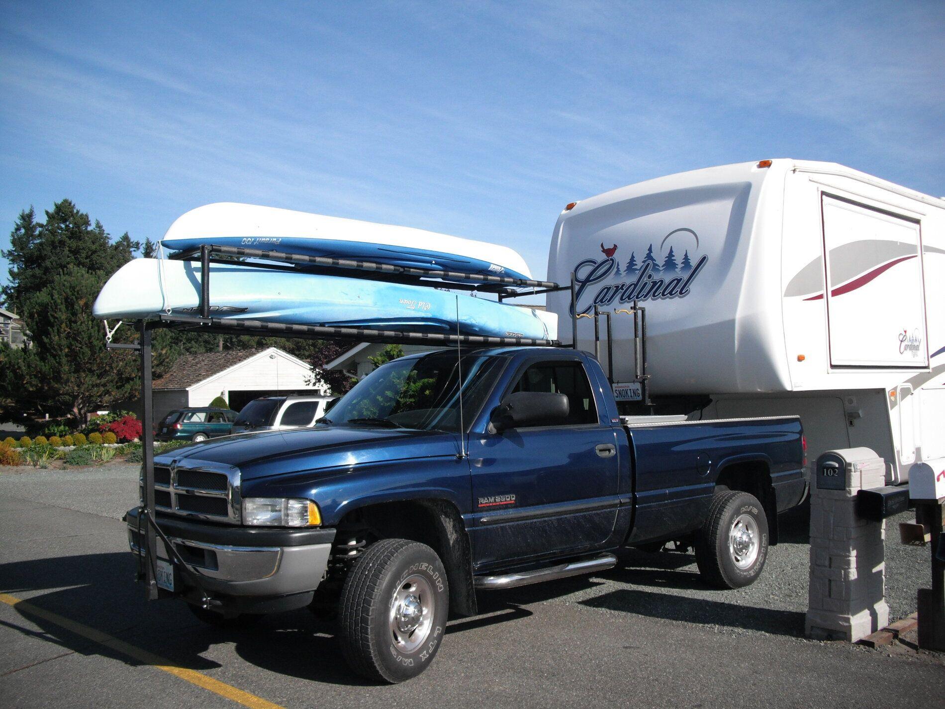

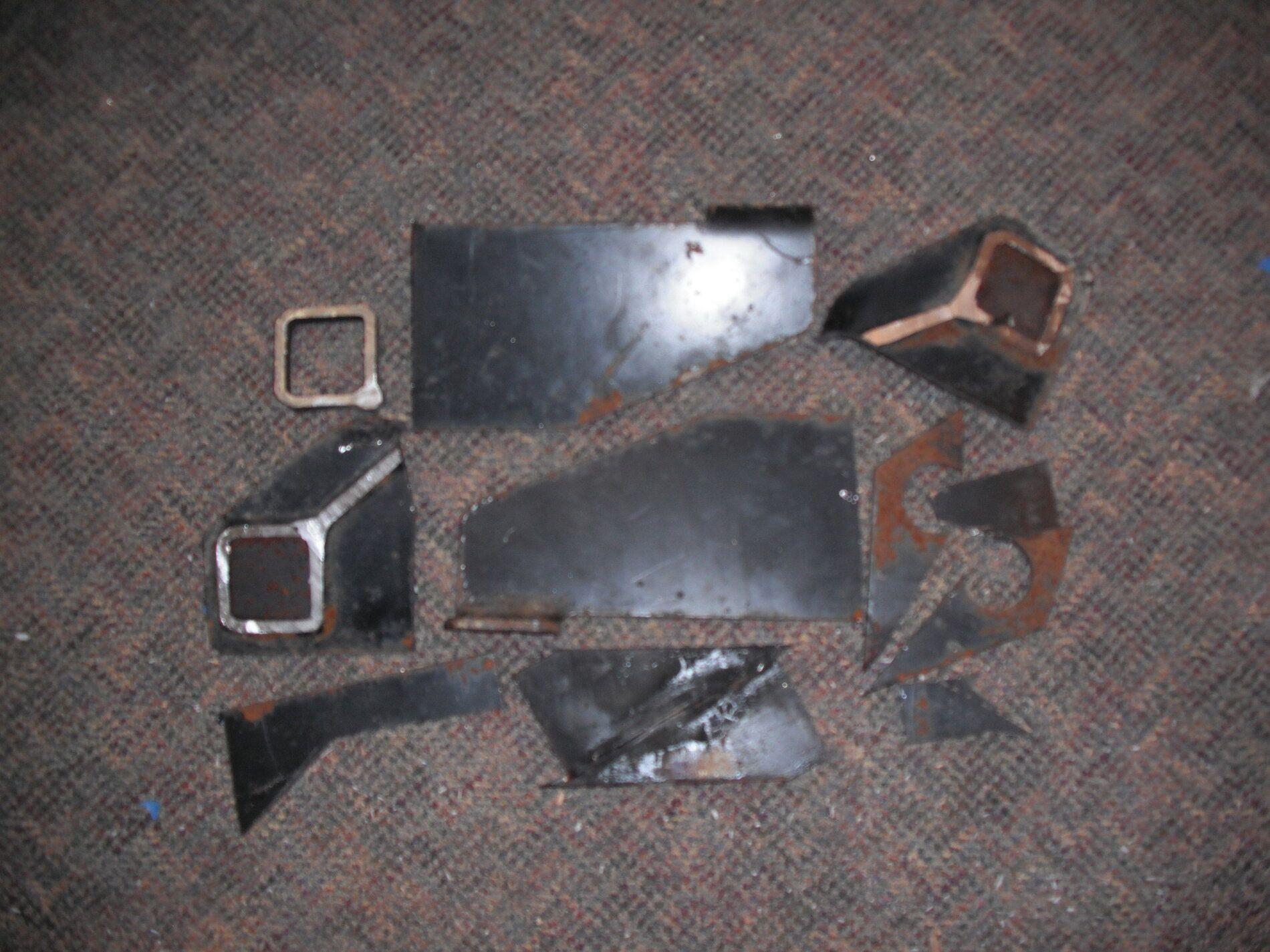

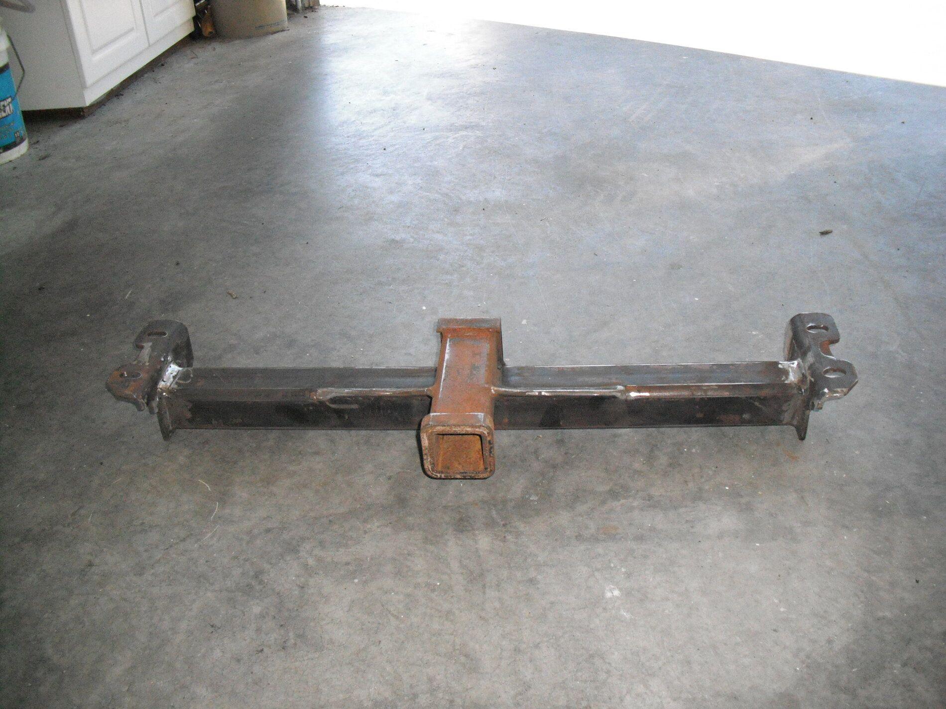

On my 2001.5 I built my own front receiver out of a junk yard rear hitch for a kayak rack. To brace it from avoid teeter-totter and such I put braces to the tow hooks.
