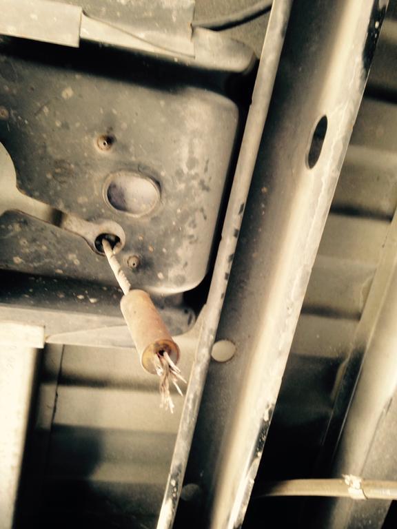

Just tried to lower the spare and the winch rod gave some fight at first, but now turns in both directions without doing a thing. Before I cut the stupid thing off are there any tricks to get the winch to move?
IIRC there is at least one roll pin in the linkage. You may have bent or lost one when turning the crank.

I lost one on a superduty once. It hit the ground at speed and came back up picking the back of the truck up off the ground (or at least it felt like it). It dented the bottom of the bed, and almost ripped the bumper off the truck.
We need to slush the cable or it will rust and fail. I've been giving the cable a coating of heavy duty corrosion spray from CRC and have never had a failure.
It was the R clip that connects the shaft to the winch that let go. It might be a good idea to preemptively change that clip out every few years if you live in the rust belt.

Mine was not corroded when it failed.
I swapped in a newer spare tire last year. I slathered up the cable with wheel bearing grease and sprayed a bunch of Fluid film into the winch body.
