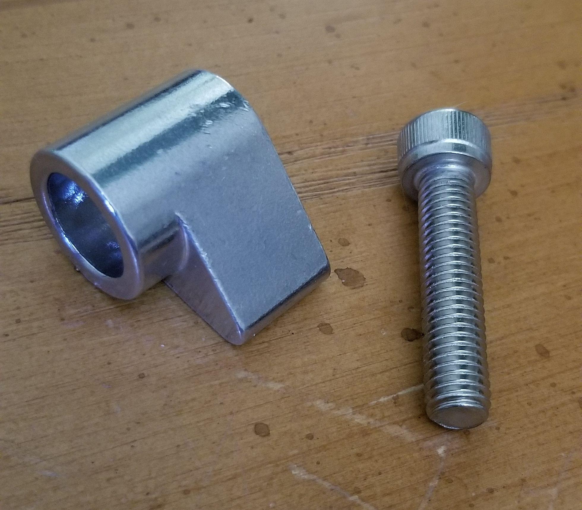

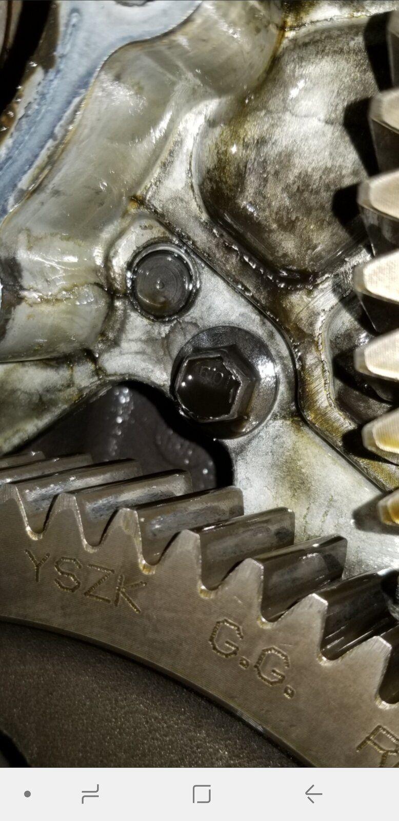

Ok so how common is it that our trucks need the speedi sleeve installed and is there a "typical " amount of mileage when this happens? I just found out my truck never had the KDP tab done to it (approaching 300,000) while it was getting the speedi sleeve installed and this was while the truck was at a Cummins shop. I got the truck when it had just over 150,000 on it so is it possible the sleeve was needed already? I've read countless articles where guys even said they were replacing the crank seal and a speedi sleeve was installed and they removed it and didn't replace it and had no problems afterwards. Just found this out about KDP and sleeve from previous owner. Thanks for any input!

For what it cost (kit was free delivery) to get things online anymore I just ordered this one. Heck for all I know it may be tabbed but previous owner said Cummins shop said "don't worry about it" so I have no way of knowing unless I dig in.
