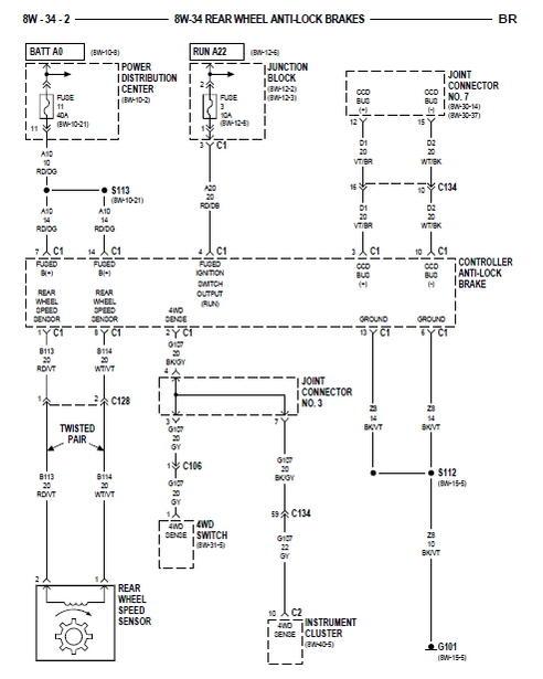

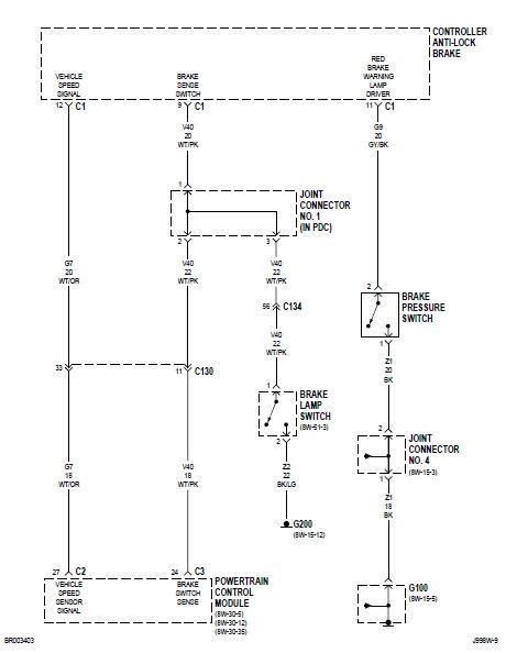

The speedo on my 2000 Ram behaves erratically as soon as I start the engine. It flickers all over the dial whether the truck is moving or not. I have a Scangauge II permanently connected to my OBD port which also shows erratic speed readouts.
I have changed the speed sensor in the back axle and the output shaft sensor in the transmission but the problem persists. Can anyone suggest where I should look next
