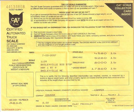

This is what mine scales out at...
Megacab w/33' Cougar Fifthwheel. Wife and I in the cab. Loaded with food, fully stocked for extended stay, grandkid stuff, some firewood. All tanks dry other than 10 gallons of fresh water for toilet and hand washing use while in transit. Propane tanks full. Truck full of fuel.
Mike.
