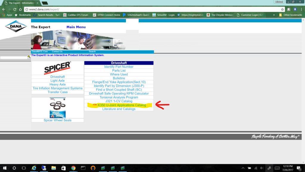

Go here....http://www2.dana.com/expert/
Then select the K-350 U-Joint Catalog...

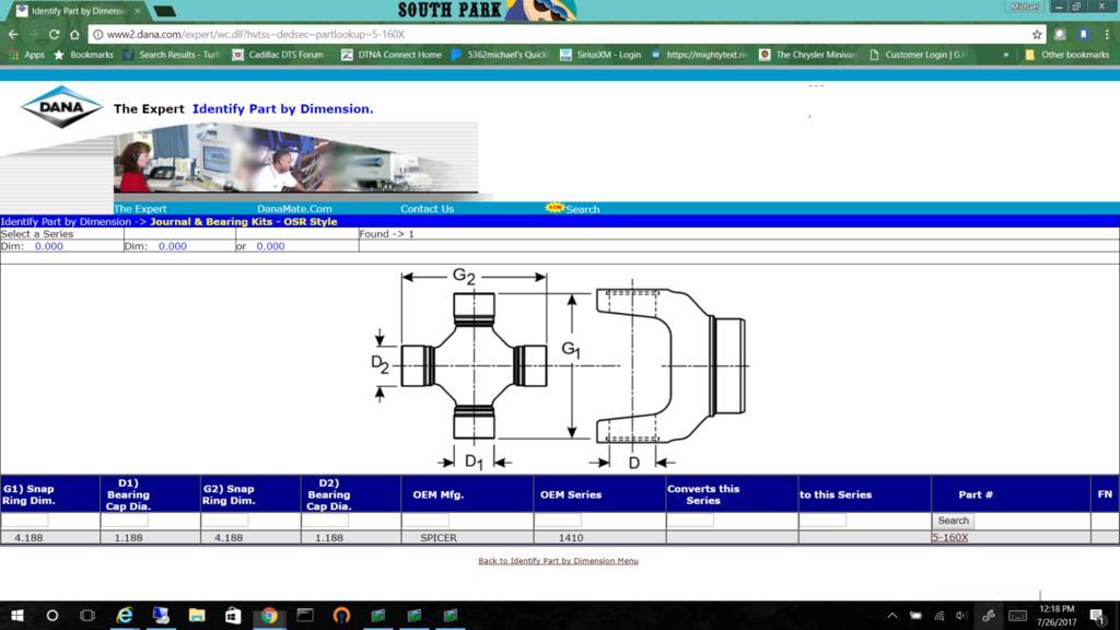

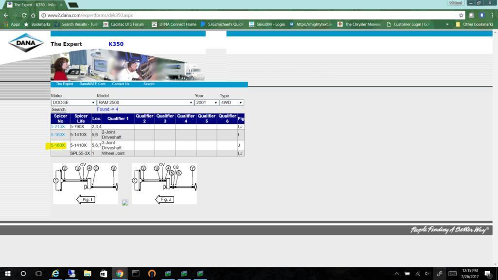

Hit the u-joint part number to the left in blue and it will take you to the dimensional information. Don't forget that our trucks are in there as "Ram 2500", not "2500"....
5-1410X -- about 27$ + s&h from summit racing. the u joint strap kit 3-70-28x, & i think it's about 8$.
ps - 5-1410X is pre-greased & sealed. no zerk fittings. sorry, but i don't know spicer's greasable counterpart.
5-160X would be the greaseable version. See Left Column of Dana Expert chart above.

I have 5-1410X. I went to the Drive shaft shop and had the guy measure the truck. These are sealed no greaseable.
I have not put them in yet. I may be doing it later today. I will let you know if they do not work out
I just had the rear rear and the front front replaced on my truck. The invoice lists them as 5-160X and 5-213X (5-1203X). I believe they are spicer but I dont know which is for the front and which is for the rear drive line.
