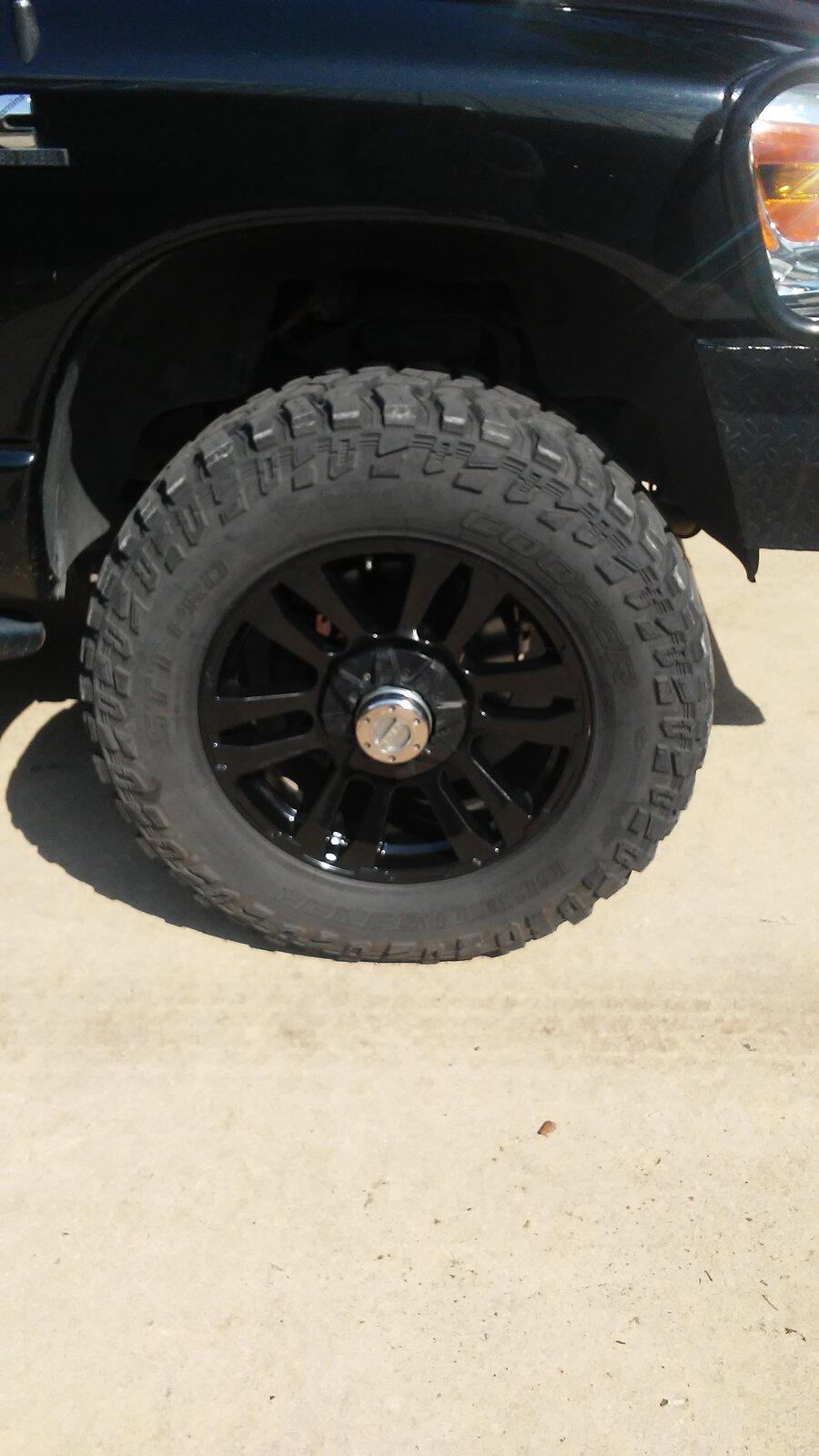

And I say they'll work with the Gen4 rims, their center cap doesn't fit over the Dynas from what I've learned.
