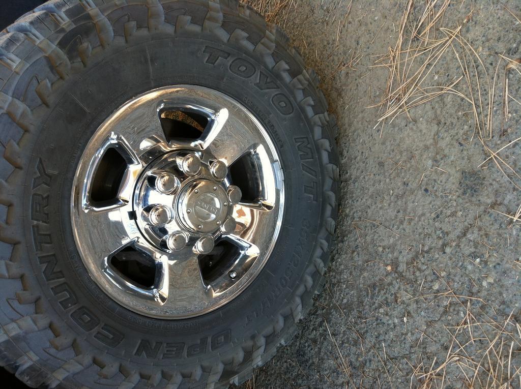

Here are a couple of pics of my Spyntec's installed with the factory center caps. I drilled a pilot hole from the inside out and then a hole saw, slowly from the outside with someone holding the center cap. It worked great and smooth.
