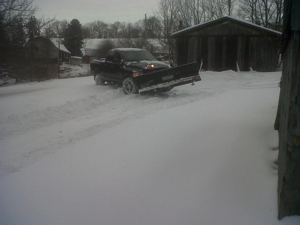

Here's our '04.5 with the Hiniker plow set up we are currently using.
Other than the factory snow plow prep group, nothing special.
I've got that same setup on my 04. I put the factory 988 series springs in mine and have had zero problems.
This is what you need (988's)!
Your current springs should have a white factory sticker wrapped around one of the coils, and usually the driver's side is 1 number higher than the passenger side, ex: driver side #$%^&#**984, passenger side #$%^&#**983, the driver's side spring is heavier because of the driver and fuel tank. The 988's are available for the "snow prep" package, although I have seen them utilize a 986/987 combination.
Keep in mind the 988's will be rough riding without the plow...
