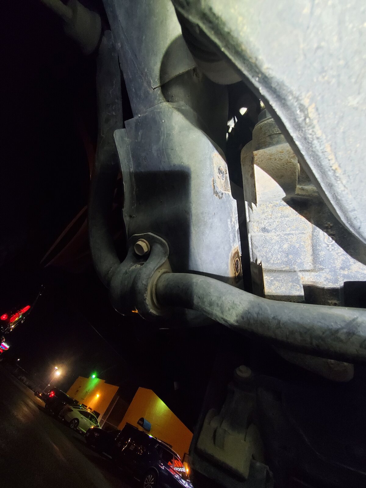

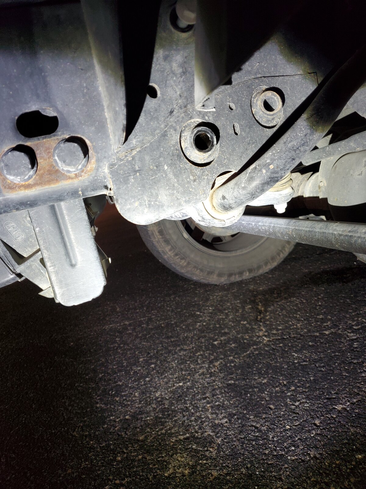

@Derril, From the pics, it looks like there is a tiny bit that went all the way through. If that's the case, start soaking with some ATF and Acetone mixed 50/50 to help loose threads. Then I would try to get a cross cut done on the exposed threads to try and unscrew. Other way would be to put a nut over the threads and fill the nut with a weld. Have had good success with both options. Hope you can get it without to much cussing!
