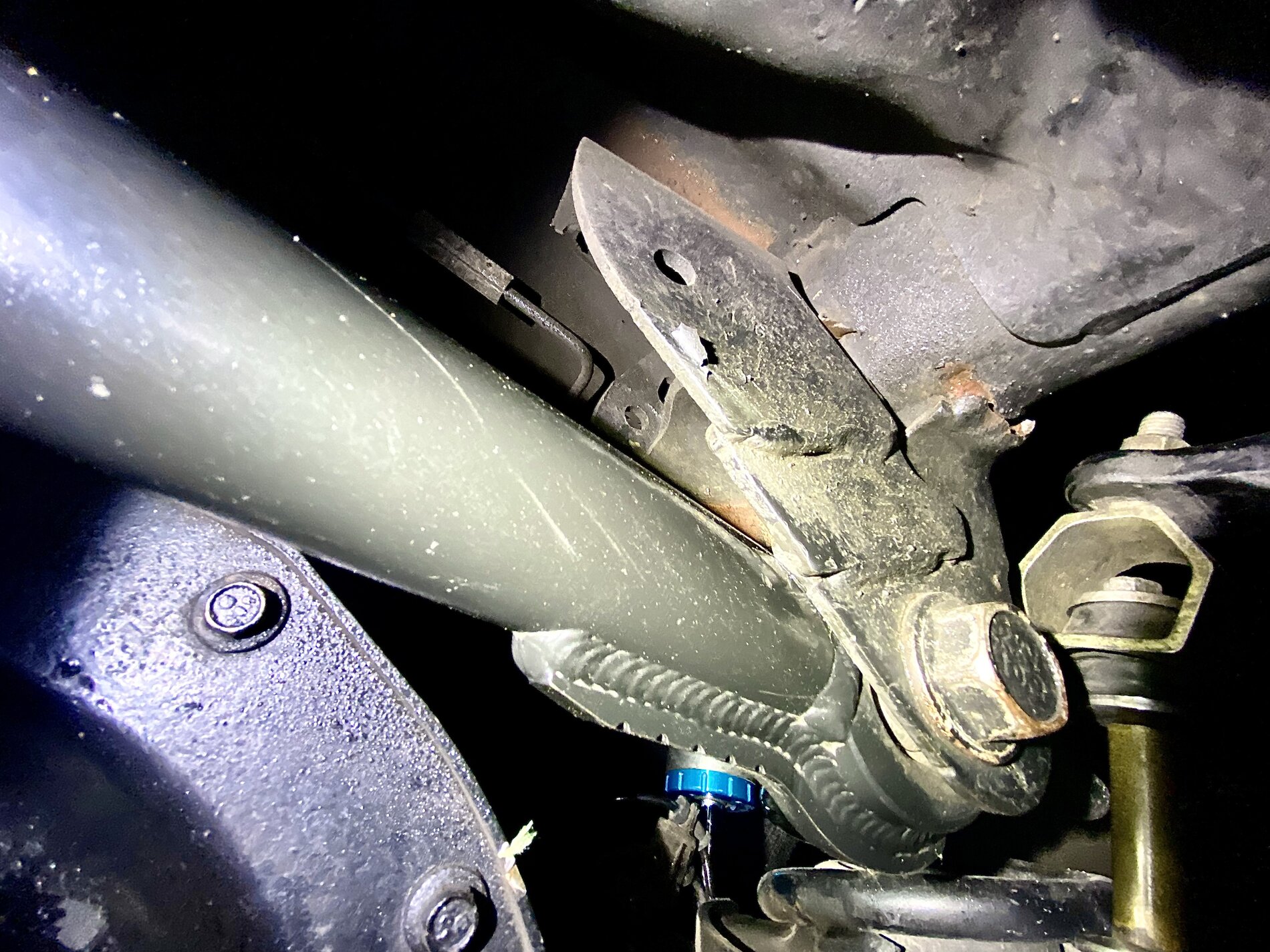

Well, I DEFINITELY got it figured out! I figured it might help to jack up the frame in order to let the suspension fully extend, and that immediately revealed the problem: the welds @ the trackbar bracket -> frame failed. Yikes!
So I started doing a little research, and imagine my surprise when I almost immediately discovered an active recall (R46) for certain 13-14 trucks due to faulty welds at the track bar bracket. The strangest part is that I've never heard the first word about this recall - its never appeared on my recall list on Mopar's site. Adding to my confusion, it has never been mentioned at the dealer! Last year the truck was back at the dealer for a replacement 8.4 Uconnect Nav unit (which is already failing again...fun stuff), and they were very concerned about the wheel stud recall, but never mentioned the trackbar bracket. This leads me to believe it wasn't showing up for them either. So I logged into my Mopar account, and right there it was...listed alongside all the others. I have no idea what the deal was, but I'm glad its covered. Looks like I'll be driving the 12 Valve to work for while until they can fix it. Anyway, thanks for the suggestions everyone. This one is is solved.
