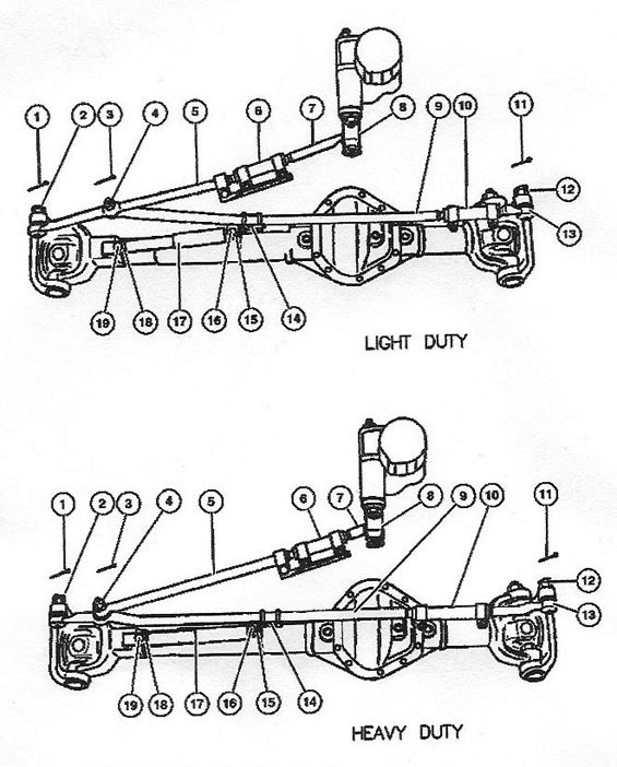

I am trying to go a different route. It appears that for '98-'99 an HD t-style steering was an option. The individual parts are readily available aftermarket and are very reasonable. Plus, if I re-use my old adjusting sleeves, I can save even more.
Does anyone know if the 98-99 HD parts will be a direct fit on my '01?
I don't understand what taper this is talking about. Is the stud taper the same?

I have 336k miles on my '01 with all original parts, there appears to be no slop anywhere and my tires wear perfect but I have always had to drive it. My '91 D-250 almost drives itself. Just looking at the difference between Y and T, the T has to be better. With a solid link between both knuckles there should be no dead spot in the steering wheel or bump steer. It looks like the Y can do all kinds of goofy things pertaining to suspension movement or steering input.

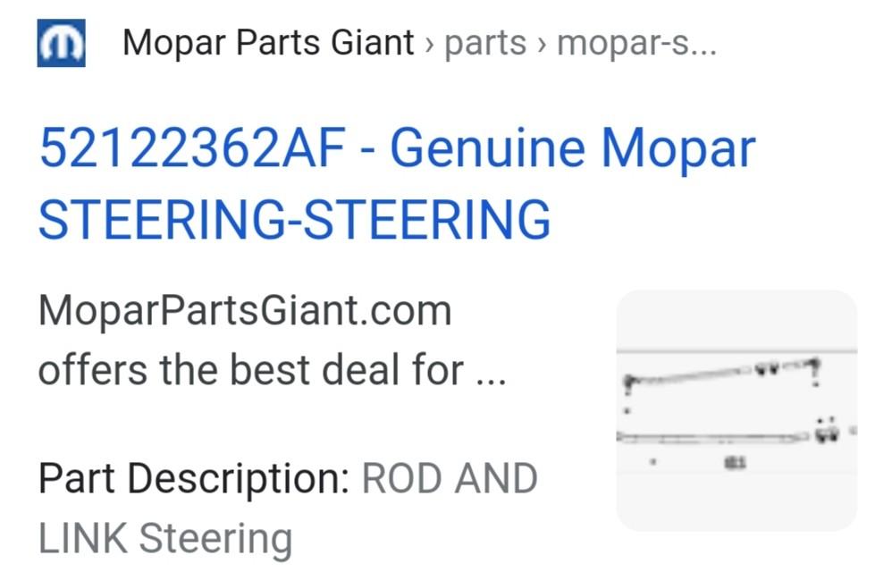

Some good info here, says the 98-99 HD oem tie rods have a different taper than my '01 so that lets out my plan to use them. That the 2000-2012 are the same, so this Mopar #52122362AF kit should fit.

Mopar #52122362AE, AF, AG, AH, AI, AJ, AK all appear to supercede to the "AL" suffix.
Update to this. I installed the 52122362AF and it was a direct bolt in. Also installed a Rare parts adjustable track bar. At the same time I readjusted the bearing preload in the steering box and the combination of all that completely tightened up the steering. Drives like a new truck. Best upgrade I've done
