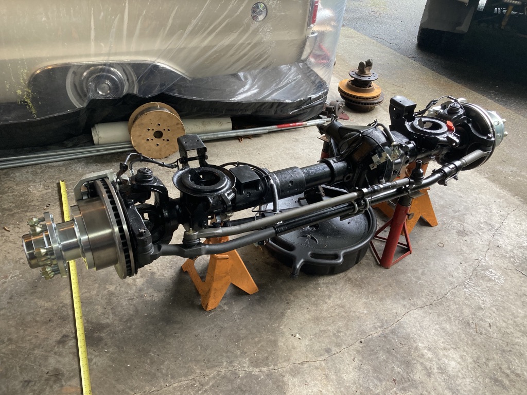

I replaced the stock 1999 front axle with one I rebuilt out of a 2002 3500. installed a Red head steering box new steering shaft. After three years no more wobble or crown chasing.
