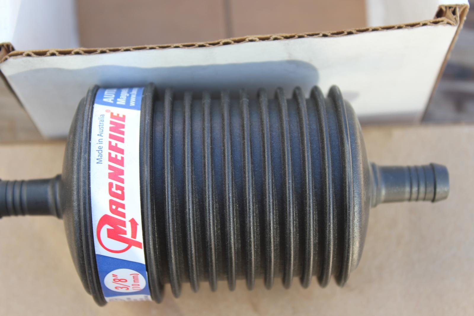

$12 at Summit or about double the cost of standard fluid. The system only holds one quart, so one quart for flush and one for refill. I also recommend a power steering fluid filter, good stuff.

Now that I am running filters in both Dodges, (the Ford conversion always had a filter) I don't flush anymore, just drain and change filter, then refill. I also run an oil cooler (oem Ford) and aftermarket on the '01, nothing on the '91.
