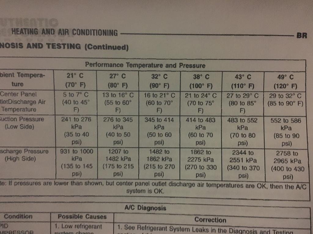

2nd Gen Non-Engine/Transmission Still no ac
Found a chart that shows what psi I should have on the gauges low side is high high side low . Causes drive belt slipping fixed orfice tube not installed bad compressor
