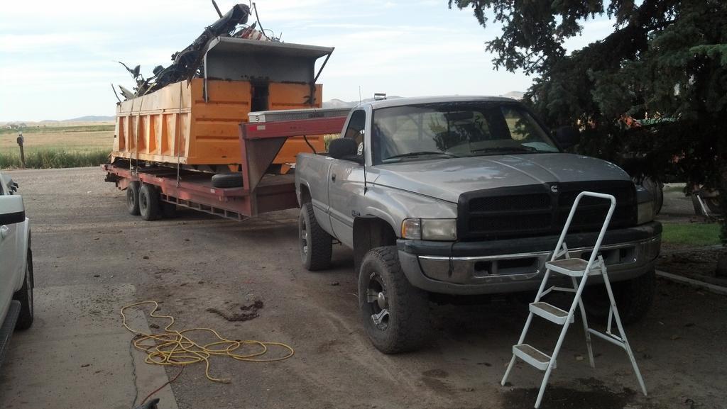

Got a new fan clutch coming and if that's still not the problem I'll pull the coolers and radiator and pressure wash them I flushed the radiator again to see if there was anything still in there that didnt help any . Going heavy today I had to stop several times to let it cool down . Coming back empty it wild run up to the last line on the normal range of gauge but it wouldn't get any hotter light weight is 14180 today . So I'll report back tomorrow
The rad was in fact plugged like you all said looked good but it wasn't cost 20 dollars at the car wash to clean it . Good mechanic in town also gave. Me another interseting bit of info no matter how hot the radiator gets without air flow through it the fan clutch will not activate
