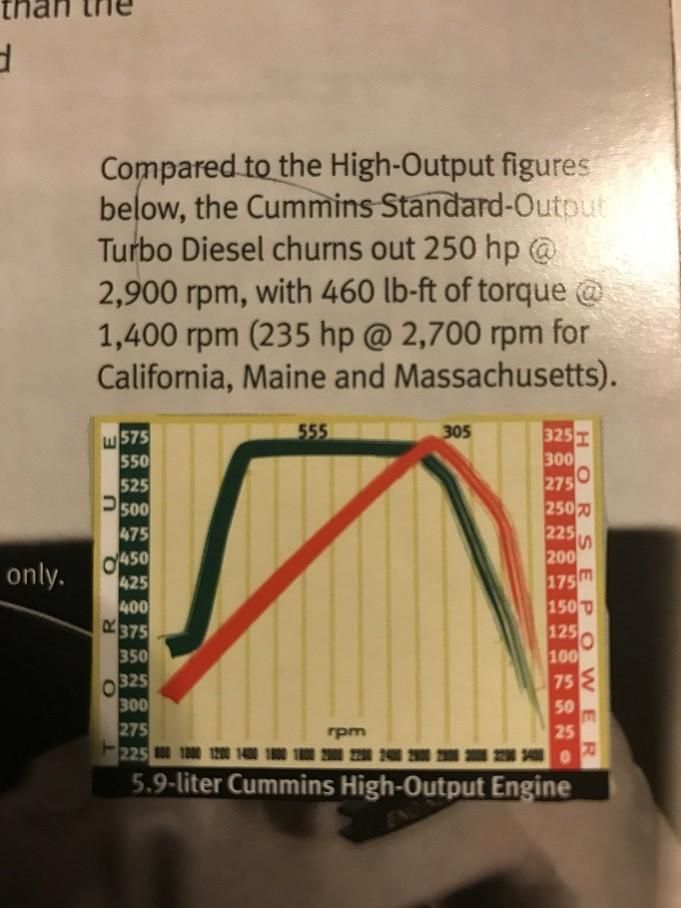

I tried looking but see advertise from performance company's and they all are radically different and find just advertise peak numbers at a given number only. Does anyone have the actual curve for HP and Torque preferably the crank values not to the wheels? Or can at least someone verbally tell me values at given RPMs from idle/slight engine load to full pull? Loving the truck and doing more data logging slightly loaded 3-4k pounds mix of payload and empty trailer for 4-5 hours then to maxing out my combined weight at as close to 23k as possible for another 4-5 hours. Yes I'm burning fuel for 8-10 hours just for testing and playing/logging data while chilling with my wife celebrating my 29th birthday lol. Thanks guys

These are from a 2003 sales brochure "2003 Dodge Commercial" page 15.
That what you're looking for?
Yes that's the Baseline before we installed the Smarty JR.
That is at the crank with all the safeties off, no where near what the engine does in the truck.
Ozy's graphs are more indicative on the curves but a little higher due to a tuned truck.
