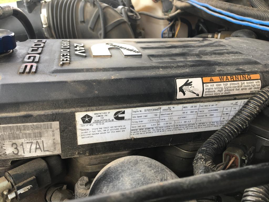

What is the hp rating on the valve cover?
Valve cover says 24 V cummings thats it unless I am totally missing something 2004 dodge 2500

There should be a sticker like this on the drivers side of the valve cover.
