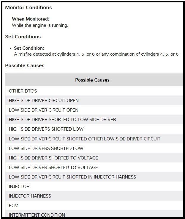

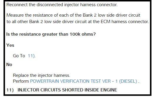

Limp mode is both, a mode the engine defaults to and a general condition of "something ain't right". The ECU will shut down a cylinder if it sees the coil resistance go high, if shorts completely to no resistance it shuts down the whole bank. Other conditions will cause the engine to derate power levels, it is all limp mode when you just limp into the nearest stopping point no matter what caused it.
