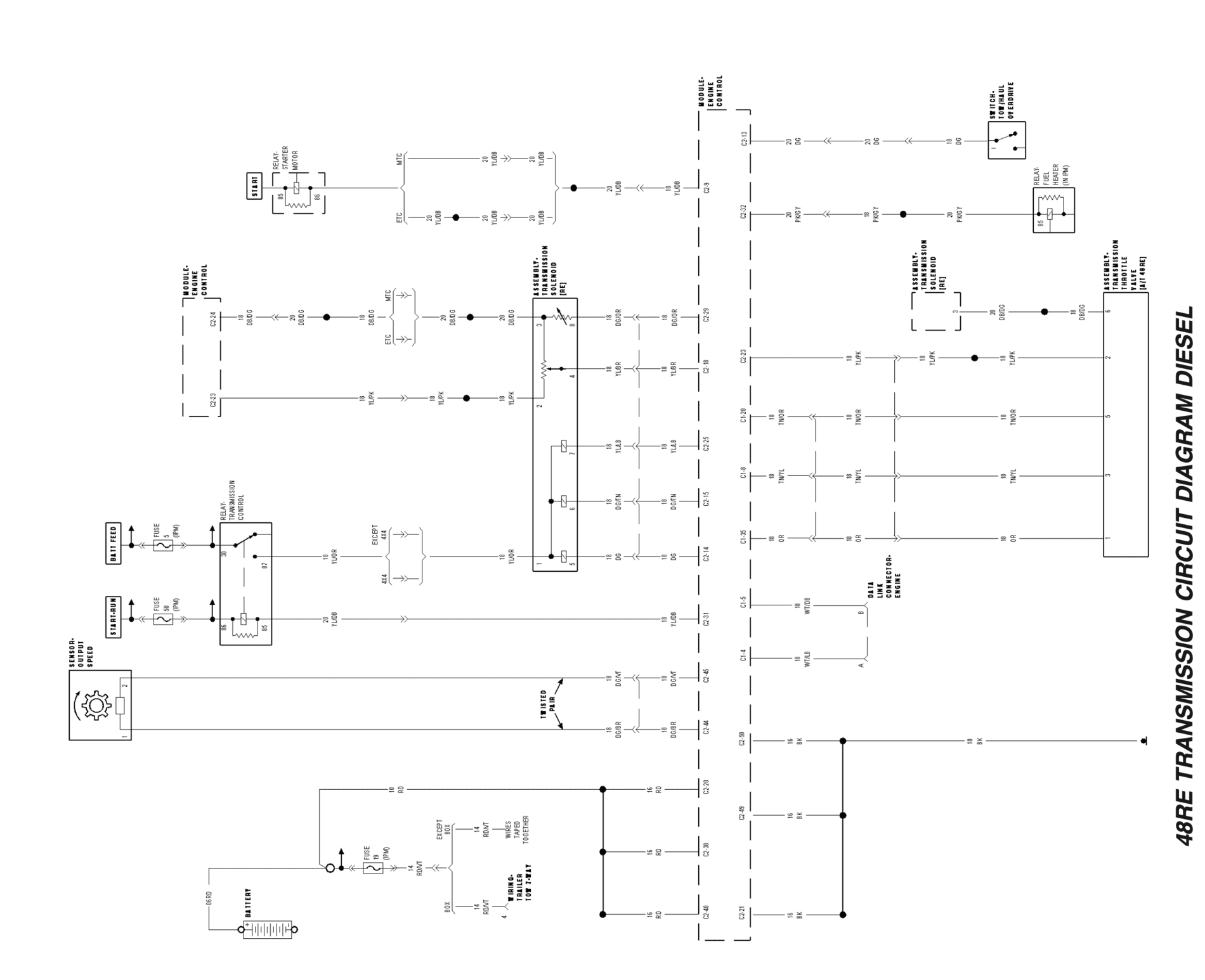

The ECM activates a relay (located in the fuse box/IPM) which then provides power to the solenoids in the transmission. The ECM can control each individual solenoid by providing ground to the other pin on the solenoid. I'm guessing that the ECM can detect faults in these three solenoids by measuring current drawn on the ground pins that it has for each solenoid.
Here's the wiring diagram for the 48RE Cummins Transmission Control:

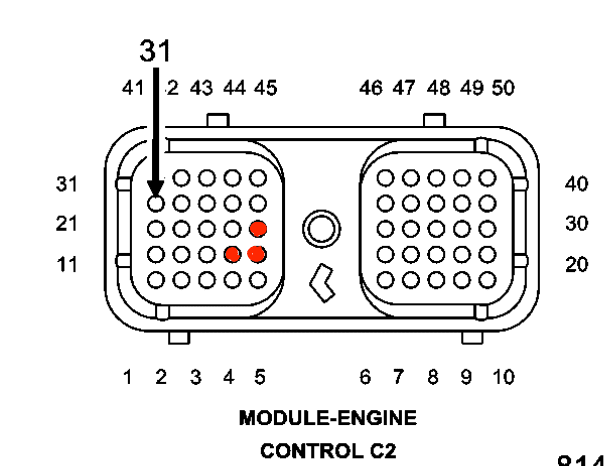

Here's what C2 pinout looks like:
A google search tells me that normally 12v solenoids should have between 20 and 40 ohms of resistance. Some quick math tells me that 13 volts at 4.2 ohms is over 3 amps. That's a lot of current for an ECM to handle, and I do wonder how long it would last like this before burning something out.
