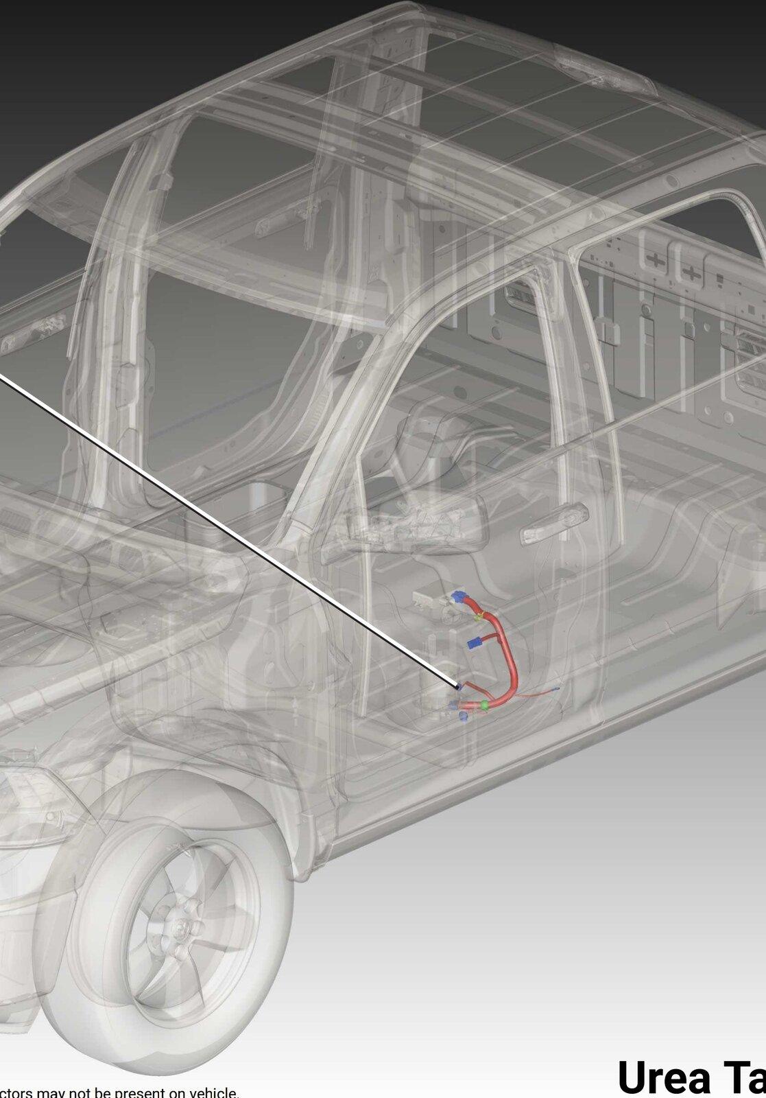

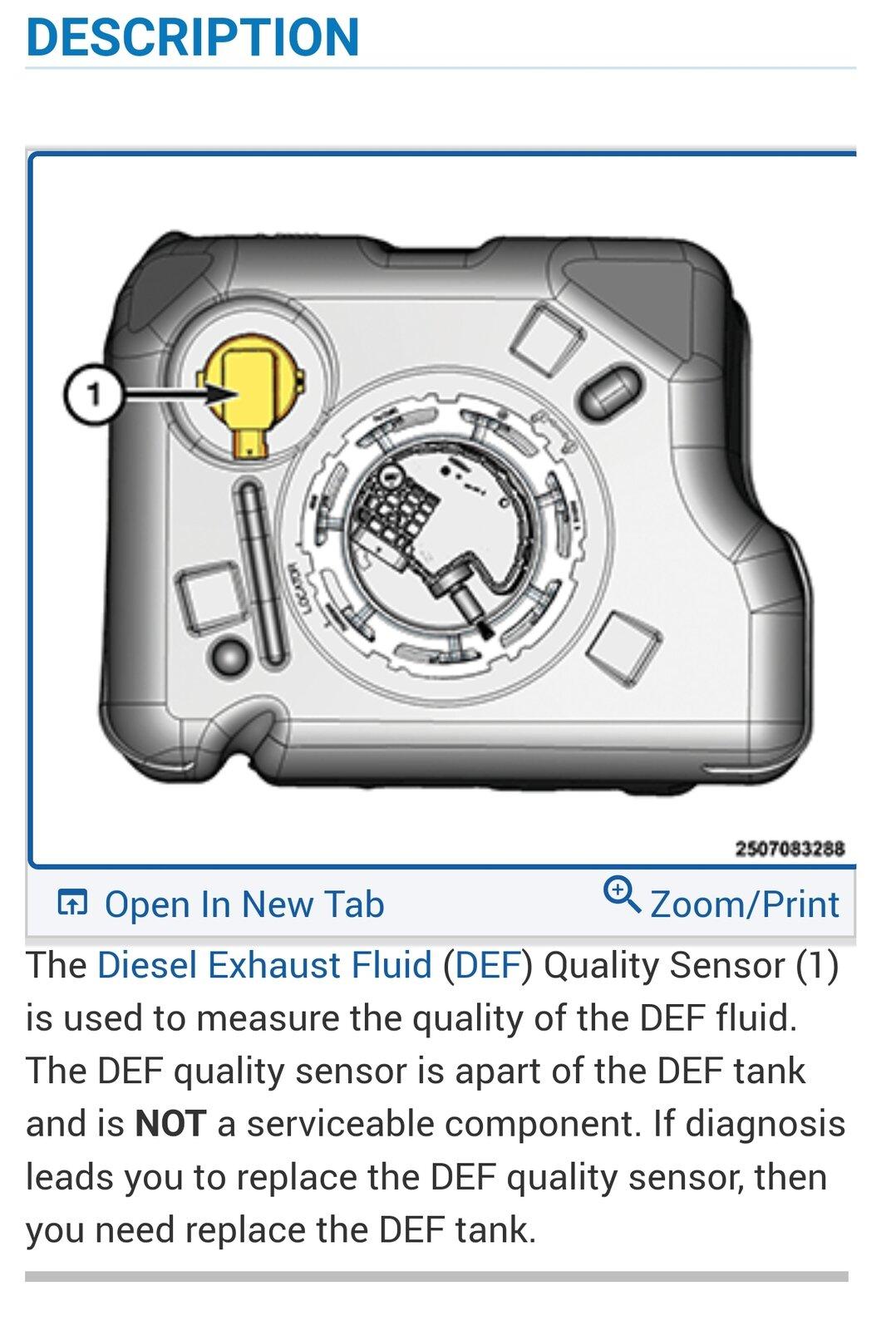

Also found the sensor is part of the tank so not a quick swap from what I read, also have not heard of alot of tanks being swapped out, other owners might share.
Sensor Location
