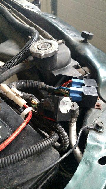

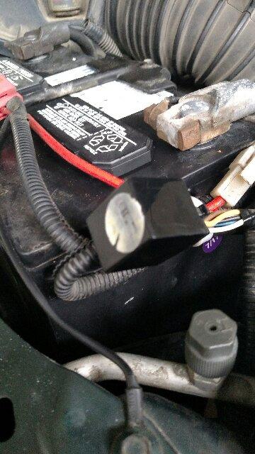

I did the headlight conversion on my 99 dodge in 2010. I used the suv lighting harness.
I just found out they are out of business. I have one relay not working. I swamped the
left one, working, to the right one, not working, and the right one works. these relays are
not standard relays as I have those on hand and it did not solve the problem. I found some
numbers on the relays, but could not find anything on the internet. I am wondering if anyone
has a lead on these relays. if not I am thinking about removing this harness and using geno's
brite box. unless there is a better or easier solution.
thanks for your help!!!!
Duane
My '06 has the infamous, notorious, and piece of crap TIPM that occasionally sends electrical spirits to mess with the otherwise proper functioning of most things considered accessories. Consequently, in an effort to circumvent this interference, I have isolated my fog-lights and running lights by building separate harnesses with relays that are hooked straight to the batteries and operated by switches in the cab. NAPA has been a good source for a standard 40/30A 12VDC 5-prong relay. This relay is a direct replacement for the one used on my exhaust brake so keeping a spare serves for standardization. I can't find a number on the relay but it looks like what you are using. Any good parts house should be able to supply what you need.
