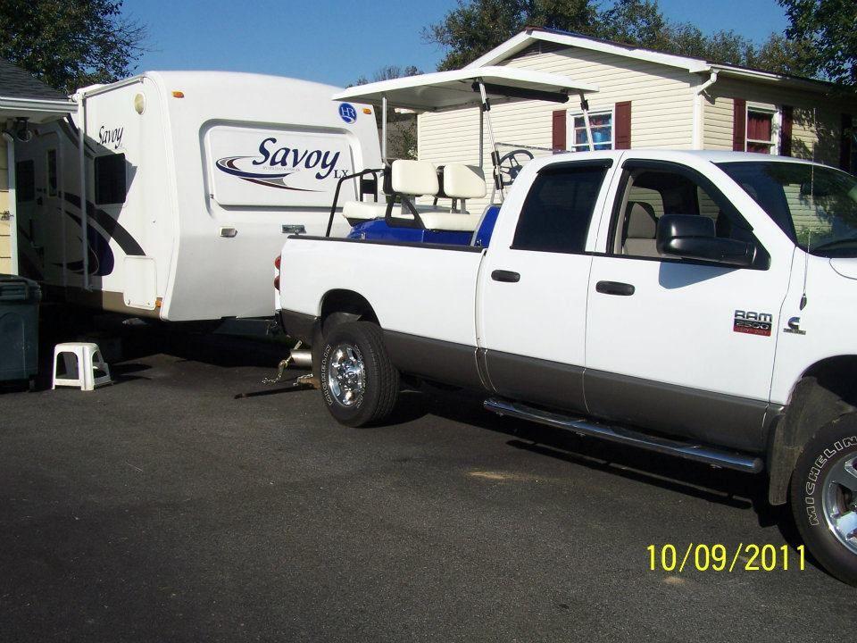

For sure a major improvement with a high center of gravity load. On the old truck (2008), I would get a lot of body roll on on/off ramps when towing with the cart in the bed. The stabilizer bar nearly eliminated it. I really didn't notice much difference in ride or handling unloaded.
EDIT: I should have added that it was totally not necessary when towing just the trailer. No issues at all until I started hauling the cart.
