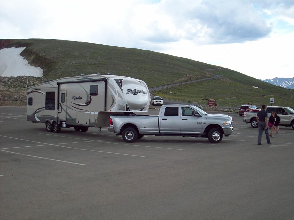

long bed dually.. is the best choice for anybody hauling a fiver, not that everyone goes that route, but its the best when you mean business..

get the dually,you won't regret it.as for short box to long box,i've used a slidding hitch in my 2007 Megacab dually,for years,i might have used the slidder a few times for really tight spots,but mostly it stays in the regular position,if you know what you're doing,you shouldn't be hitting the cab unless you're really not paying attention,as for dually debate,the dually is way better planted and stable on the highway,it just makes sense,you have double the contact patch,if you want a REALLY relaible rig,well,*** much as a electronicaly injected Cummins can be versus the dead nut reliable mechanicals,you might find an 2000 megacab dually with the last of the 5.9,without all the crap added to the 6.7,not to mention the 4'th Gens seem to have the most amount of issues,seems endless,good luck,

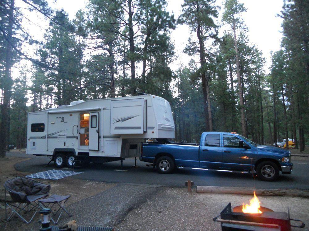

Difficult, but, I kept the 5er length down to 27'. It's not exactly a small 5er being tall vs. some smaller ones out there. Mainly for the North Rim Grand Canyon's (pictured) smaller space length limits of 27' before the largest and unobtainable 40' spots. Even a 27' takes months of advance for a reservation. The length is a comfort trade off with ease of manoeuvring. Already been in a poorly laid out "full time trailer park" falsely marketed as having overnight or short like 3 day stays where 27' was too big. 4 parked cars moved, clearing the wall and light poles with 3 spotters, visitor behind me with a TT has to pull through my spot to park his trailer then disconnect. And after all that couldn't put one slide all the way out because it would hit the long term resident's outdoor swing set. I will be more careful of that in the future.
