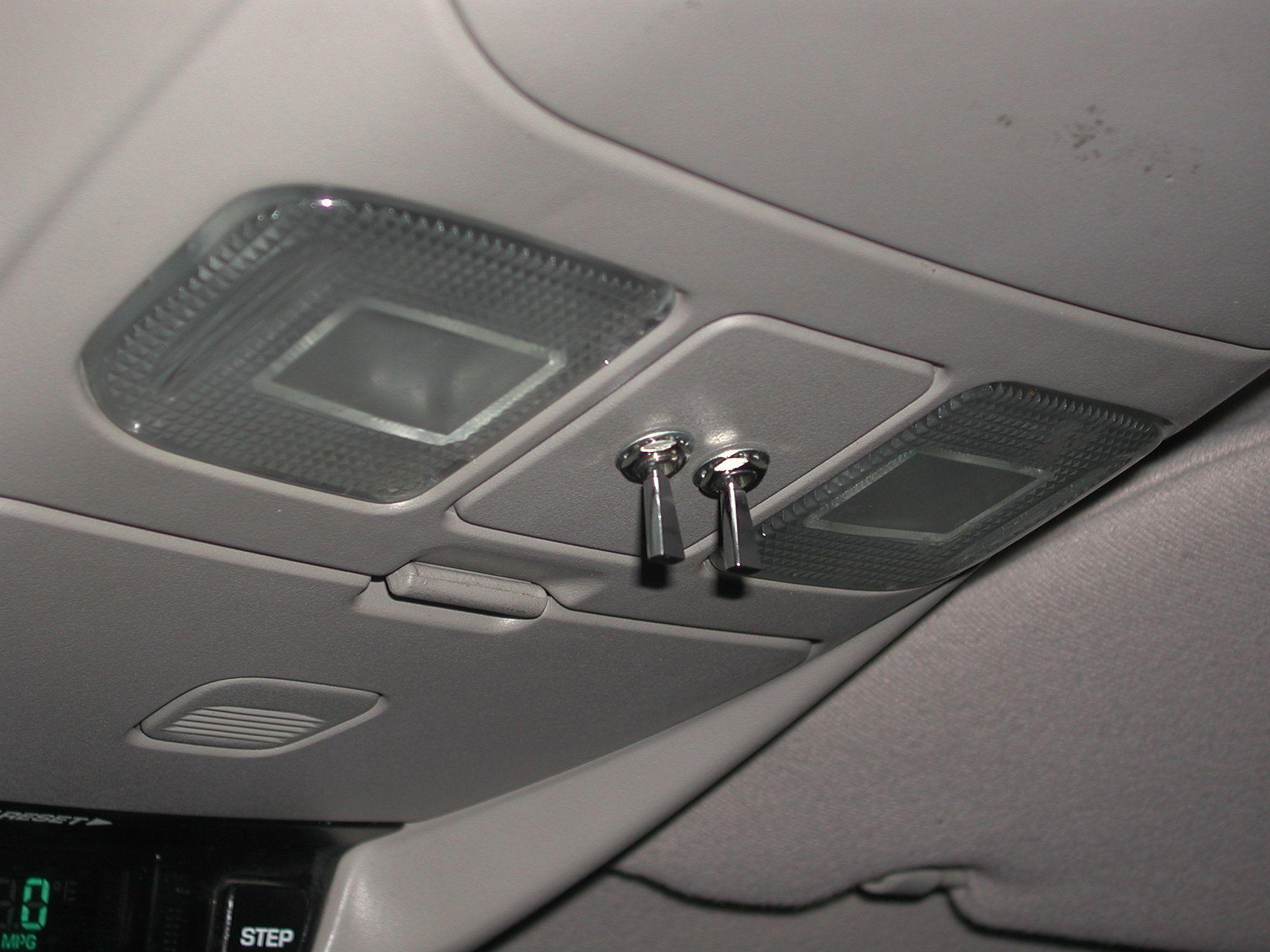

I had a 2nd Gen - when the lens switches broke, I put these in.
