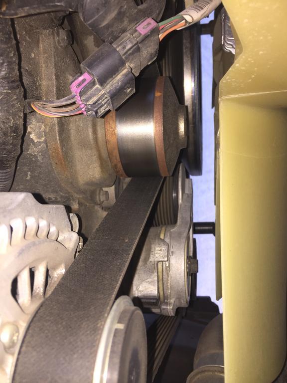

Not all trucks get a new water pump, it is an inspection and replace if needed. Just had the recall done on my 14 last Sat., did not need replacing.
If your pump looks like this it WILL be replaced! The shaft will be flush to end of pulley and then will be a rough casting on the entire tapered surface.
The pic is of mine.
