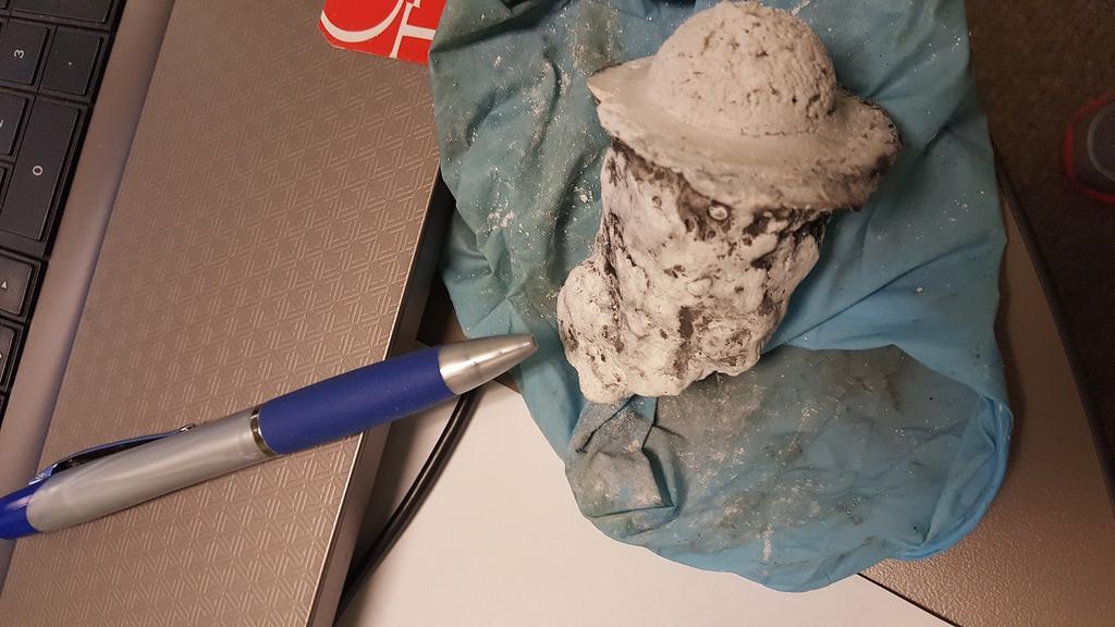

Coincidentally, I have a very loud, high pitched squeal when applying my engine brake. The tech has just informed me that they discovered this big-*** crystallized DEF plug in the SCR that is being replaced right now. Once the truck is back on the ground, I will road test it to see if it this got rid of that high-pitched sound.
Here's what we just found in mine:
Holey F'K! Looks like a mud dauber nest. <LOL>

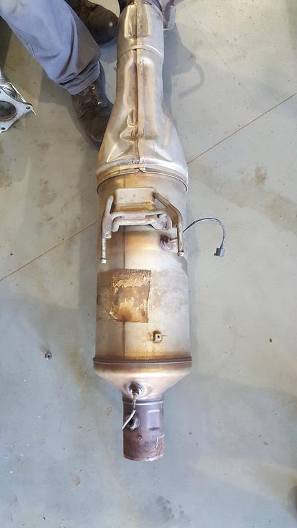

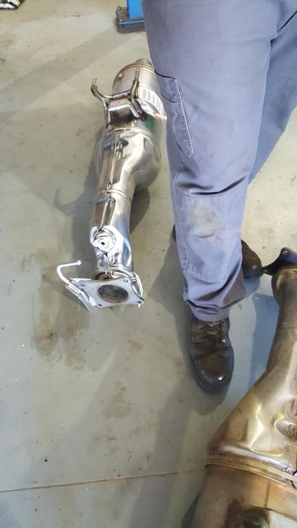

Hi Hippy43,
below are a few more photos. This is the SCR and DPF combined.

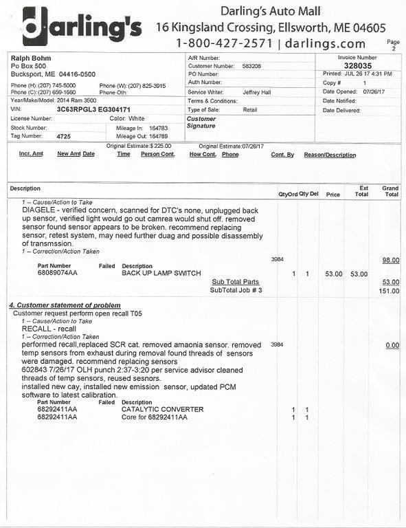

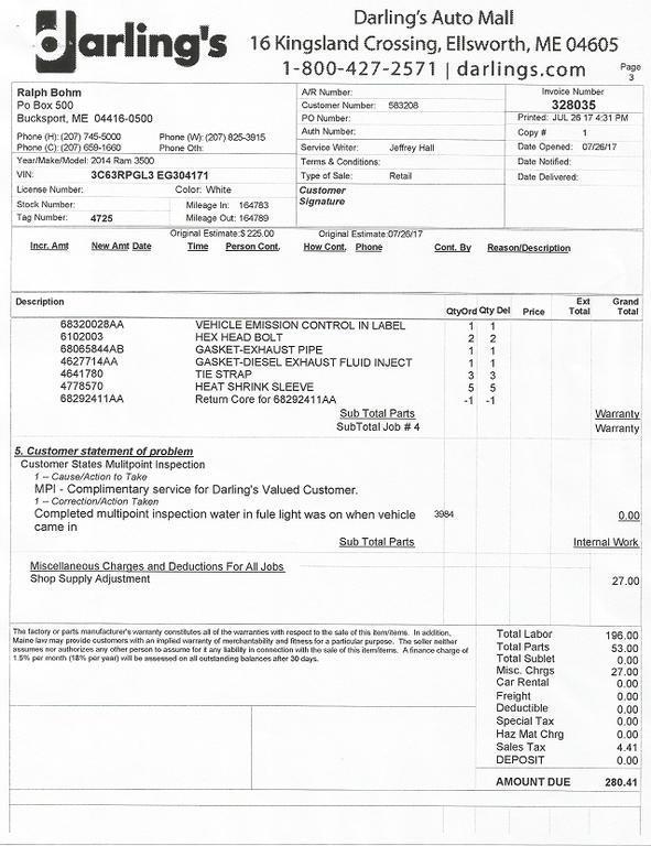

Thanks Truckman! Did they replace the DEF injector too with this or am I thinking of the wrong location?
Hippy,
I don't think so. It's not in the list:
Ralph Bohm - 2017 0726 - Truck maintenance - Darlings Recal and Repairs (2) sm.jpg
Ralph Bohm - 2017 0726 - Truck maintenance - Darlings Recal and Repairs (3) sm.jpg
I also road tested the truck with the tech. I still have a very loud whistle/squeal when coasting with the engine brake (EB) on.
