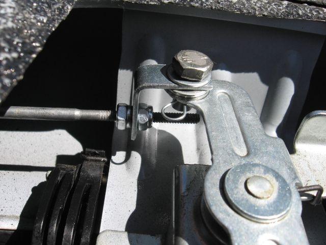

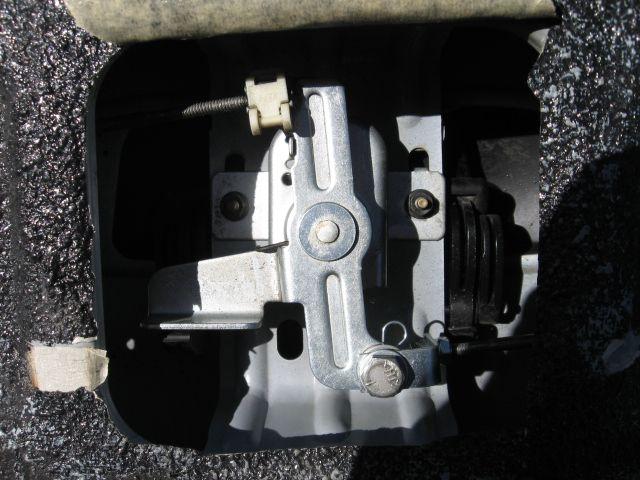

I was unable to find a clip that would work so for a couple dollars I fabricated a simple rod attachment. All parts from your local ACE Hardware store. The following pics show the result. T.

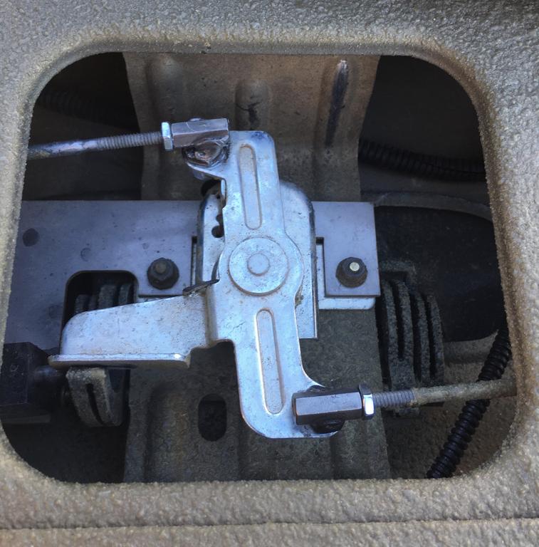

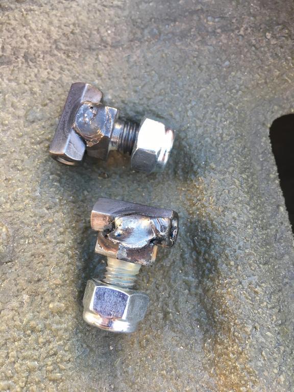

This was my solution. 10 X 24 connecting nut welded to a 5/16 X 1/2" bolt with a 5/16" lock nut and a 10 X 24 jam nut to fight vibration. Pretty easy and cheap hardware store fix that is permanent.
