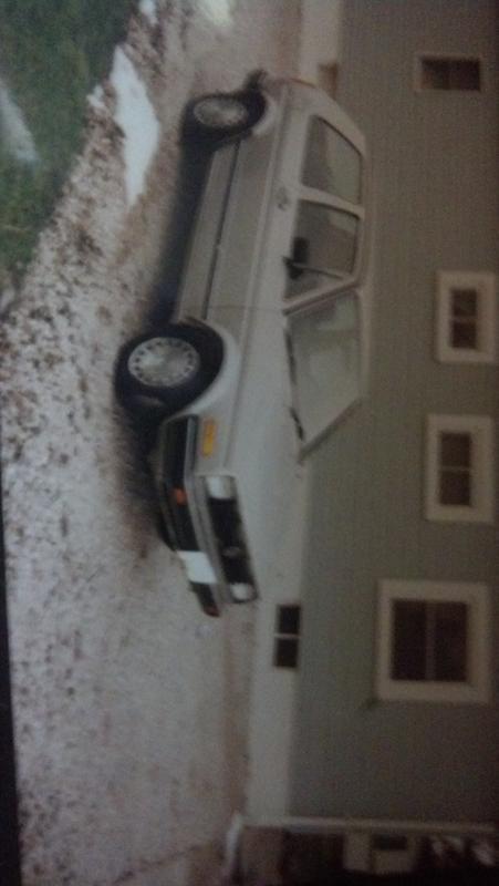

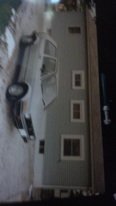

The last VW I had wasn't a TDI but more like a... . well a DI I guess... . :-laf 85 Golf, non turbo, off road fuel sipping black smoke belching gutless wonder. And I loved it. In hindsight it was one of the best cars I had for the price, I saved it from the junkyard, put an injection punmp in it from a wrecked Jetta, and drove it another 100k before scrapping it. They sure have come a long way since then!

Just for fun here is a picture I dug up of ' ol silver... .
Can't figure out how to rotate the picture :confused:
