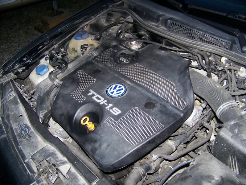

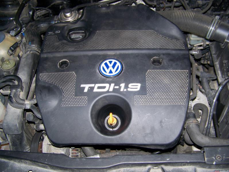

Gizmo has been missing his pretty little engine cover ever since I bought him. Had checked into a replacement but was approaching $200. 00 or so.
Asked the previous owner if he might still have it last fall. The other day a VW engine cover shows up on the doorstep, HE FOUND IT!!!:D

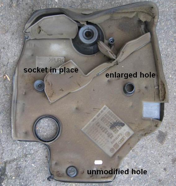

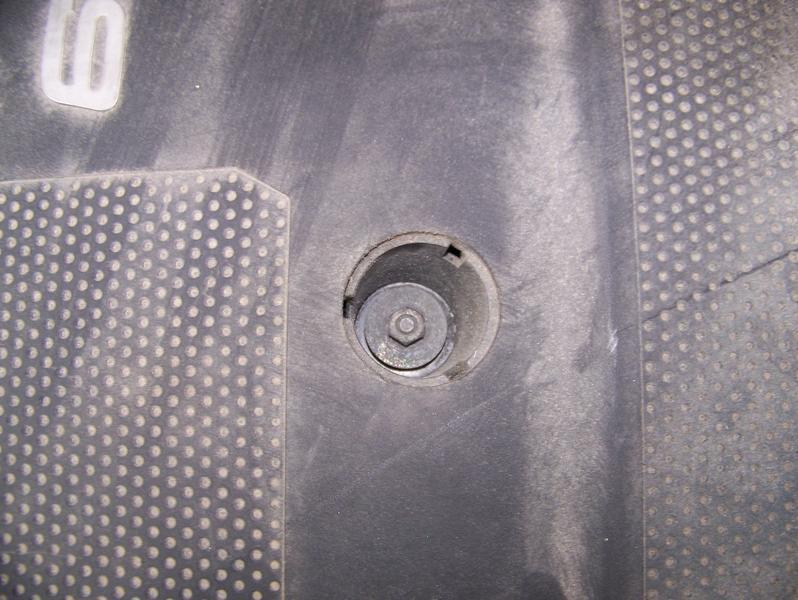

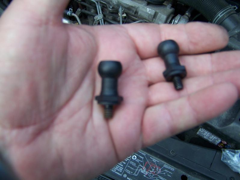

The fasteners had seen better days and as I researched the replacement parts I discovered an upgrade. You remove the existing studs and replace them with a VW ball stud, enlarge the holes in the cover to accept the newer socket / grommet combo and it converts the cover to a pop off design. No tools needed to remove the cover after the upgrade.
No one seems pleased with the stud and nut set-up that came from the factory.
It only requires 2 studs and grommets to do this, the VW geeks say not to bother with the one in the rear on the intake.
Part numbers are...
06A-103-226 (2) Socket @ 6. 00 each
06A-103-951 (2) Ball Stud @ 11. 50 each

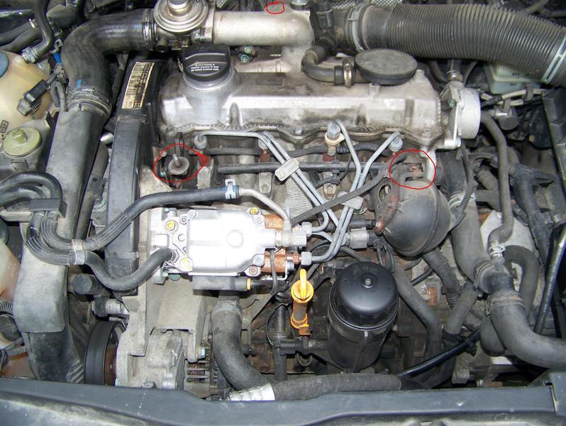

Dusty Ol' Cover

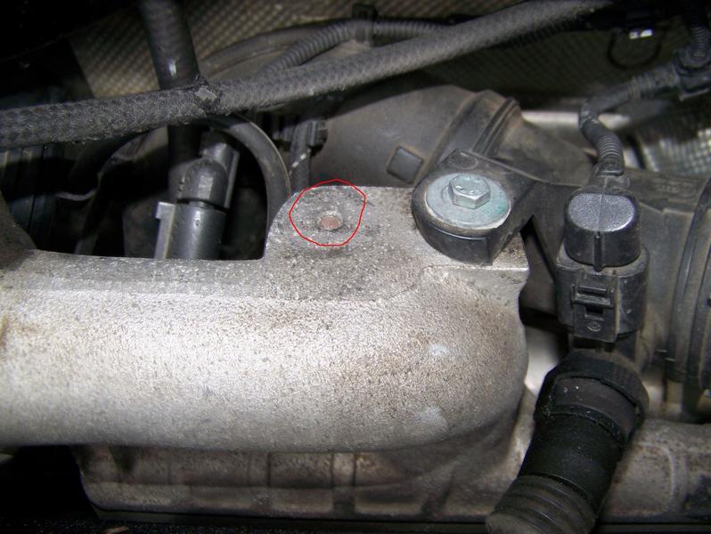

Broken Stud In The Intake Manifold (A present from someone that over tightened it in the past)

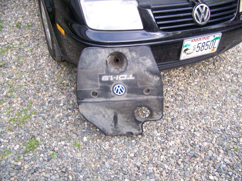

Front Mounting Points

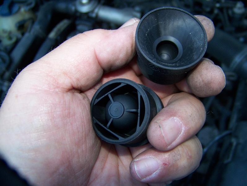

New Style Ball Stud
New Ball Studs Installed
