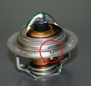

There isn't any need for any of that with a 12 valve. The jiggle pin (has the little hose attached to it) bleeds air from the engine when it is not running. It's in the FSM . So after a few starts and stops all air is purged.
Yes...I'm just finding all this out now in reference to the OEM Cummins t-stat having jiggle pins and other aftermarket one's not.
You misunderstand. The jiggle pin is a separate item, it is not incorporated into the t-stat. The little curved hose is attached to it on one end, the other end bypasses the t-stat housing and exits the air into the upper radiator hose fitting.
Can you provide a reference picture of this jiggle pin?
Look on the top of your engine. You will see a small 6 inch long hose. One end is fitted over the top of the jiggle pin (fsm name) the other to a fitting on the front of the upper radiator hose connection. Cummins quickserve (You have subscribed to it, correct?) lists it as a check valve PN 3926761
