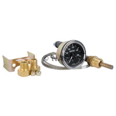

Here ya go Gary: They use a line similar to a thermocouple on a gas furnace. They were used forever on off highway equipment.
Really Nick? It is still an electrical signal, just self contained. To me, a mechanical gauge is like a pressure gauge that has a billows connected to a needle. Pressure moves the billows, they are connected to the needle. The needle moves mechanically, thus a mechanical gauge.
No...not electric at all, just mechanical....here is a link to Summit Racing, they list 124 mechanical water temp gauges. Read the specs, no 12volt signal, as in a sender with a wire. What do you mean self contained electric signal? How do 12 volts get in there? https://www.summitracing.com/search...N=4294951097+4294951021+4294944911+4294951006
It isn't 12 volts. It is millivolts produced by a bi-metal probe.
Okay, maybe you call it electric but I call it mechanical, as does every one that sells that type. If you ask for an electric water temp gauge you will get one that requires 12 volts, if you ask for a mechanical, you will get one that doesn't.
A better comparison is a speedometer. My '54 Ford speedo has a cable that drives a gear in the gauge. Truly mechanical. The speedo in my Dodge doesn't utilize 12 volts, it is another self contained system. So is it mechanical too?
