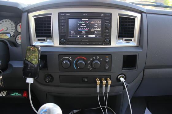

Thanks mike, that was what I was looking for, the PLX fluid temperature sensing module as shown in the pic, is what I will be purchasing. The sensor's I plan on installing, is the EGT, boost, trany cooler with the sensor, transfer case sensor, and diff's covers with sensor's, when I pull my trany to convert the DMF to the SBC DD3250. There will be no need of gauge pillars or clumsy gauge sets where they look out of place and take up room in an already crowded cockpit. goodguys75, I can install a lot more and look at them on my NAV radio if so chose to, and my drivers side dash remains the same as it is now as in the pic shows.
