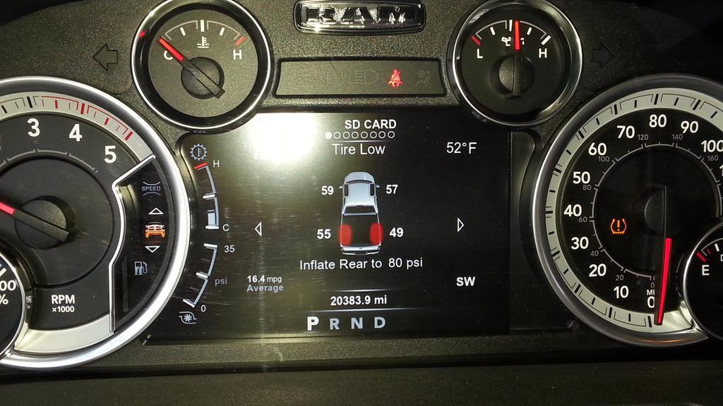

jackknife, have not found any way to change my evic, wonder if you are thinking about another version since I have the uconnect 5.0. All mine shows is a bar with a low to high or cold to hot.I can set up different gauges but don't see any way to change from bars to degrees.

Does your EVIC look like this? Obviously, the image in the center will be different depending on what screen you've selected.
Not exactly but I did find the boost gauge, changed the trans view to it so I can watch it. Don't have the tire pressure or the SD card but other than that it is the same. Thanks! Didn't remember the boost gauge until I went through the menu again.
