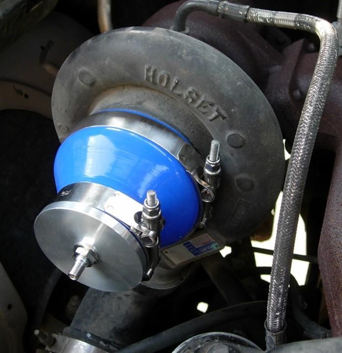

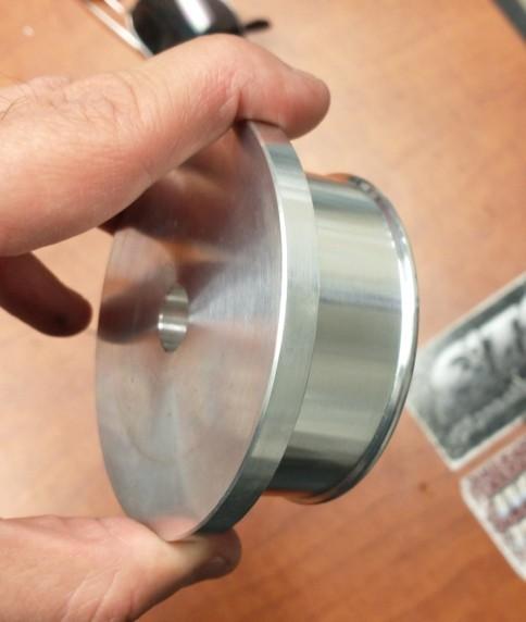

I found several places that sell boost leak testers online. siliconeintakesdotcom. maperformancedotcom. turboboostleaktestersdotcom. These all appear to be small American companies focused on gassers, but a 4" intake is, after all, a 4" intake. I purchased the tester pictured below for $30 + $8 s&h from silicone intakes. Works great! More on that later. No one had any end caps for sale, which forced me to make one.

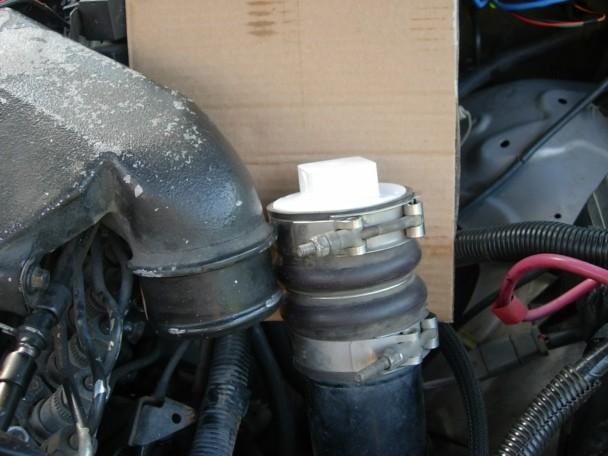

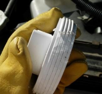

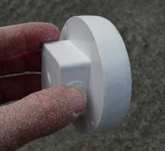

This is a misunderstanding, rather than a myth: a 3" schedule 40 pvc pipe has an outer diameter of 3 7/16" - not 3". 3" is ID. The stock rubber couplings do not wish to encapsulate a 3 7/16" object. I thought a 3" plug (not cap) would have an OD of 3". Not so. Cut(utility knife)/file/sand/grind off the threads on the plug. If you've got a lathe, consider yourself blessed. For those of us without one, keep the ground down plug as circular as you can. Mine leaked a tiny bit, but not enough to foil the test. My final plug diameter was 3 3/16". Before installing, wash off the pvc bits, because this part of the system comes after the air filter!

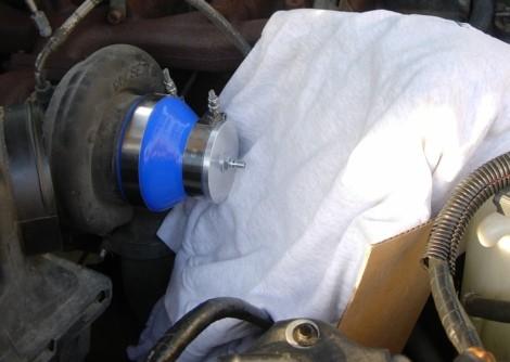

Start with 5psi and work your way up. Pressurizing the system can be semi-dangerous. At 20psi that 4" intake has 251# of force acting on it!! ^^ If your t-bolts aren't extra tight, you will launch that tester towards your alternator/oil filter/hand. Be careful. Wear PPE. Use cardboard/plywood/old sweatshirts to protect engine components.
It helps to buy some bubble solution - the kiddy stuff. It's a buck at the Dollar Store. I dumped it into a spray bottle and added more water. 1:1 ratio. Seems to dry off quick, but works better than a dishwashing soap solution. If the weather is hot, presoak the boots with plain ole water in order to conserve your bubble solution.
First check your tester and end cap for leaks. A leak at the tester is bad, safety-wise. Tighten those clamps! If my end cap had been machined round, I'd consider a leak there equally bad.

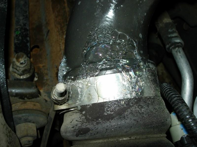

The pic with large bubbles happened at 5psi. ^^

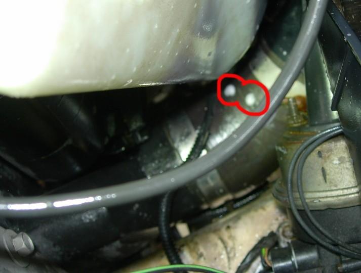

At 15psi, I noticed the two pinhole leaks.

The device has been made from billeted aluminum. It's solid! I had no issues with it whatsoever. Even the valve cap is aluminum! I worried about the transition from their 2.5" opening to our 4" opening, so I sent them an inquiry. Silicone Intakes responded in a couple hours. They said that the couplings are rated at 50psi, and that works for me.
I'm glad I made this purchase, and if you're in the market, I recommend this tester.

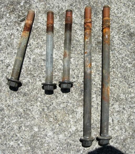

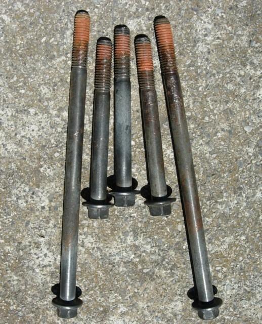

Bob4x4 & BigPapa, you're not going to be surprised, but I was! Both the plate & heater gaskets were fine, but the bolt heads leaked! Not the 2 long bolts (I removed those one at a time; pushed air through; nothing came out either of those holes at all), but rather the 2 short ones close to the valve cover. Also, I had a major leak on the bolt head that secures the return fuel line way back by cyl. 6. :eek: Now, my 3rd short bolt on the triangular wing of the air intake horn, it didn't leak, but it can. When I removed that one, air came out of the hole. FYI Test everything!
Before running the leak test I tightened all bolts to 18ft#'s. Then I tightened the leakers down to 25ft#'s. They still leaked. Also, I had wire brushed the bolts clean prior to said testing. Their seats on the horn were also clean.
I've got a solution in play: 5/16" ID metal bonded sealing washers have been ordered. Technically the bolt shafts are 8mm, but, err, that doesn't really work too well in America. I haven't decided if I'll install washers for all bolts or for just the leakers. Time will tell.
Anyway, I'm glad that you all pointed out the intake plate. Thank you. I'm also glad that I built my plug. You can't really test the CAC if your system doesn't hold pressure, and while a small compressor cannot keep up the leaks out of the cylinders, it can briefly show you where the big leaks are. Test everything!

I've done a boost leak test multiple times and never disconnected any boost hoses. I found my biggest leaks at the intake horn boot on the intake size and also a leak at the grid heater gasket.
I didn't take the sealer coating off. Anyone know what chemical/product that they use? Would a decent substitute be a low strength (purple) thread locker?

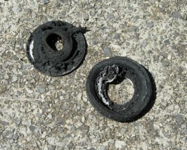

I did install some metal bonded rubber washers. They worked - sort of. Apparently mine were made in ...uhhh, overseas, and were low quality. :-/ Couldn't get them to torque to 18ft# without destroying the rubber, so I torqued the next group of washers less. They stopped the air from passing through the bolt heads, but they allowed air to pass through the intake manifold gasket because they weren't tight enough. No surprises there.
