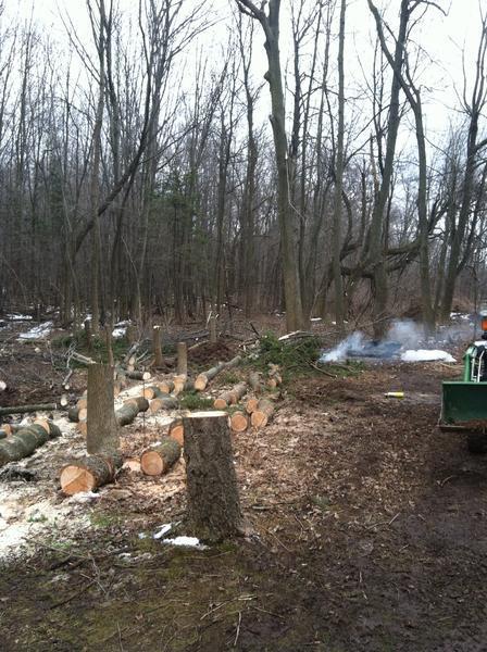

Well the site was all trees this spring.

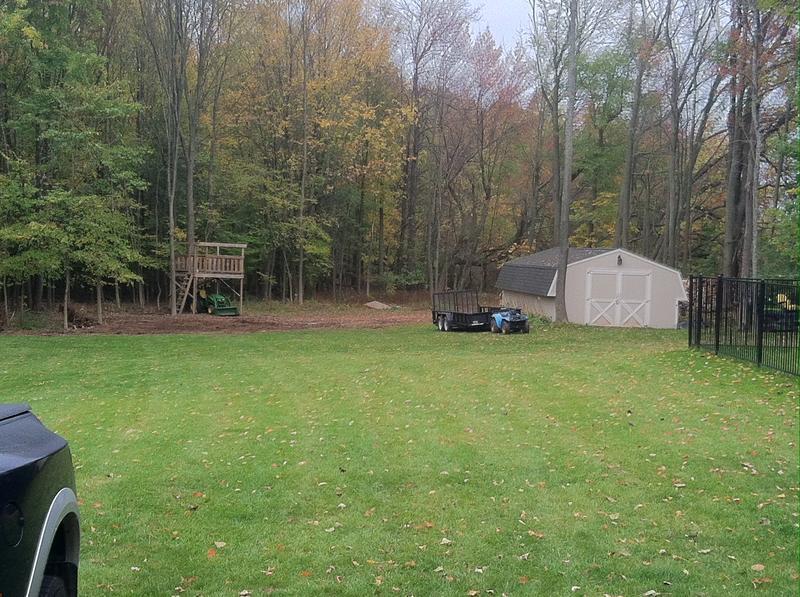

It ended up looking like this by the fall.

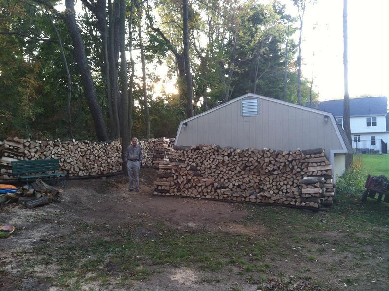

My original building size was 40X42 then I switched gears to the current 50X40 so more trees needed to come down in September. The extra hardwood was saved to dry out for next year. My 74 year old dad stacked it all by himself.

Bill- all but one of the stumps were pulled out with that John Deere. Fortunately I have a backhoe attachment for it. What I do is dig down about 2-3 feet all the way around the tree then rope off the tree as high as I can and pull it over. The stump comes right out of the ground. I didn't do that with the pine trees. They dig out easily enough. There was one huge maple that my FIL got happy cutting and just dropped it before I could dig. I spent a few hours trying to get it out but ended up talking to a construction guy 3 houses down. They were building a house and had a large mini excavator. He grabbed that last big one for me.

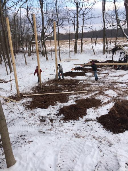

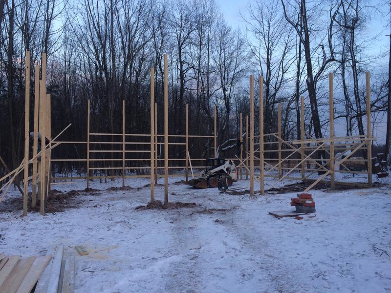

Progress was a little slow today. Freshly frozen mud made for slippery walking and they had to pull out a few of the posts they did on Thursday. They were too short. As you can see, I have a 3 foot drop from the right to left side. I need to find some fill quickly. The plan for tomorrow is to set the 6 lean to posts and hopefully start on the trusses. Sorry for the dark picture, I was waiting as long as possible to get the most progress.
I like the HID metal halide lighting. Bang for buck, I thinks it's the best way to go for longevity. Sure it takes a fee minutes turn bright but the output is amazing compared to the cheapo 4' fluorescent lighting.
Starting to look like something now, I'll bet it's exciting to finally see this going together. Those are some big posts! Are they one piece or laminated?
