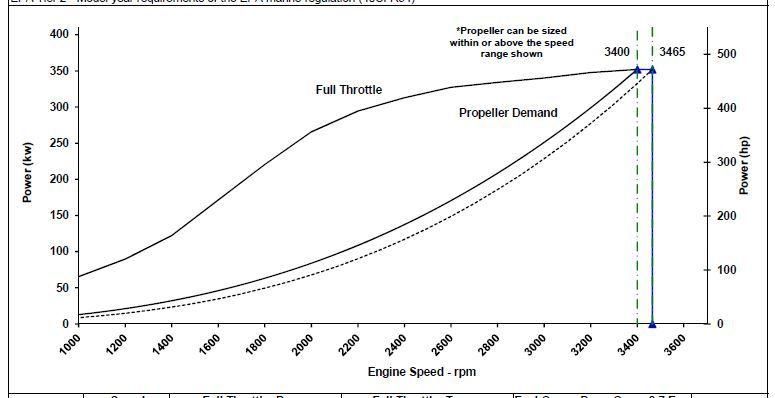

Marine cams/turbo's generally would be very laggy if they where used in OTR/pickup as they don't need full power until rpms are near rated rpms. The curve below is the QSB480, which is the highest rated OEM 5.9 made. It uses a HX55 with a large turbine housing, so just imagine trying to tow at GCWR with a HX55 single.
This curve is a great example of the difference between propeller demand and available power. Once installed the engine operates on the propeller demand curve (± a variance, but props are designed/modified to allow the engine to run at rated rpm at WOT), not the dyno curve.
