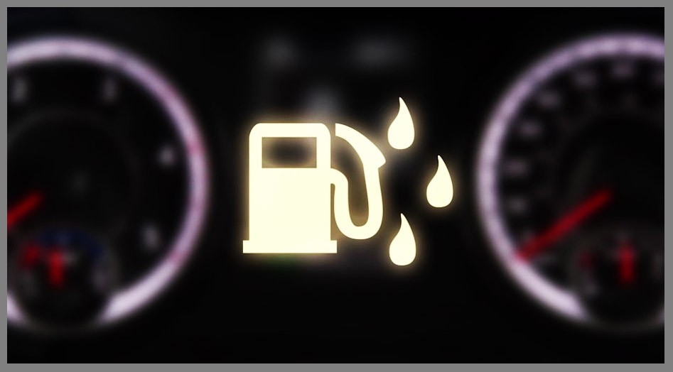

Let’s cut to the chase: If the water-in-fuel light comes on the first thing to do is to stop driving the truck.
Repeat, STOP driving the truck. Chances are you aren’t too far from the fuel island where you just filled the tank? (Our guess, about one mile away from the fuel stop.)

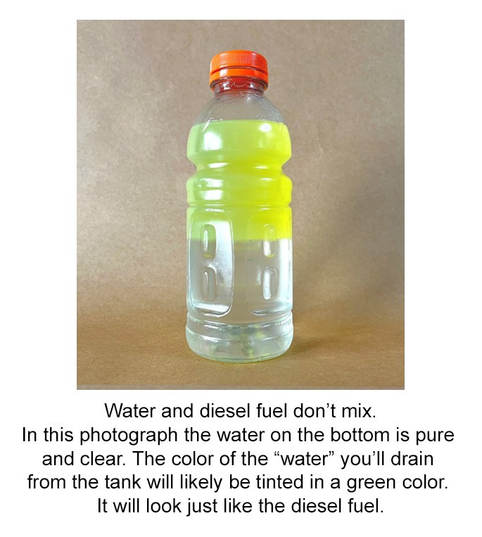

So, let’s not make this into a big deal. Water and diesel fuel don’t mix.

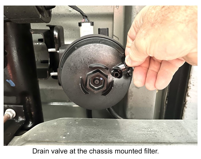

Logically thinking: If your truck is 2013 or newer Turbo Diesel, it has two fuel filters, the chassis mounted and the engine mounted filters. Closest to the fuel tank, the chassis mounted filter’s sensor was (99% certainty) the trigger for the water-in-fuel light (WIF). The repair procedure: Grab that empty, clear, water bottle from your cup holder; crawl underneath the truck; open the fuel drain valve and see what comes out.

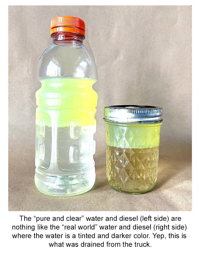

Got it all? Observe how quickly the water and fuel separate in your bottle.
Feel confident? Let’s purge the chassis mounted filter again. Close the fuel drain valve. Turn the ignition to the “on” position. Listen for the fuel pump to operate (a slight “buzz” noise). It will shut off in approximately 20 seconds. Open the drain valve and catch the fluid in the water bottle.
Got it all? Any water?
Feel confident? Use the ignition-on to reprime the chassis mounted fuel filter and purge again just to be sure.
At this time (if you have a spare) replace the chassis-mounted filter.

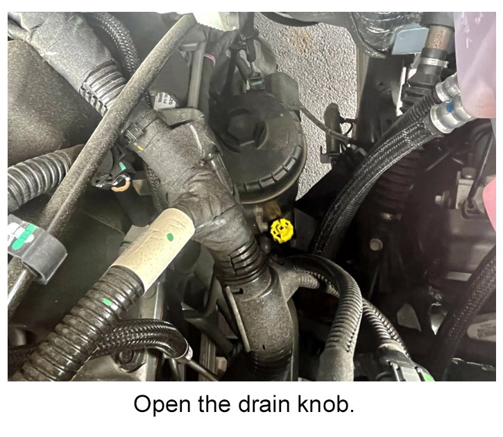

By now chances are you’ve solved the water-in-fuel problem. As an extra precaution, you can also drain the fuel filter at the engine. This filter has a lever or knob that opens the fuel filter housing to let the liquid (still 100% diesel fuel, we hope) drain down the fuel tube.
However...
However (you knew “however” was coming), the factory folks didn’t provide a lengthy drain hose. So, you are going to get your backside dirty as you crawl under the engine to put that water bottle in the proximity of the drain hose.
Open the knob, have someone turn the ignition “on,” listen for the fuel pump to operate for 20 seconds. Capture the fluid from the drain hose (what a mess) and check for water.

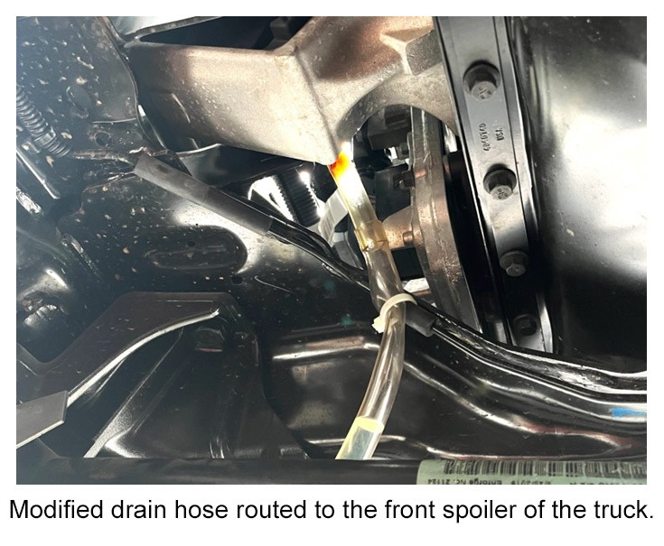

Vow to purchase a hose to extend the factory drain line at the engine mounted fuel filter. Purchase some 3/8” clear, vinyl hose at the hardware store. It will slip over the existing drain hose with a slight interference fit.
However...
