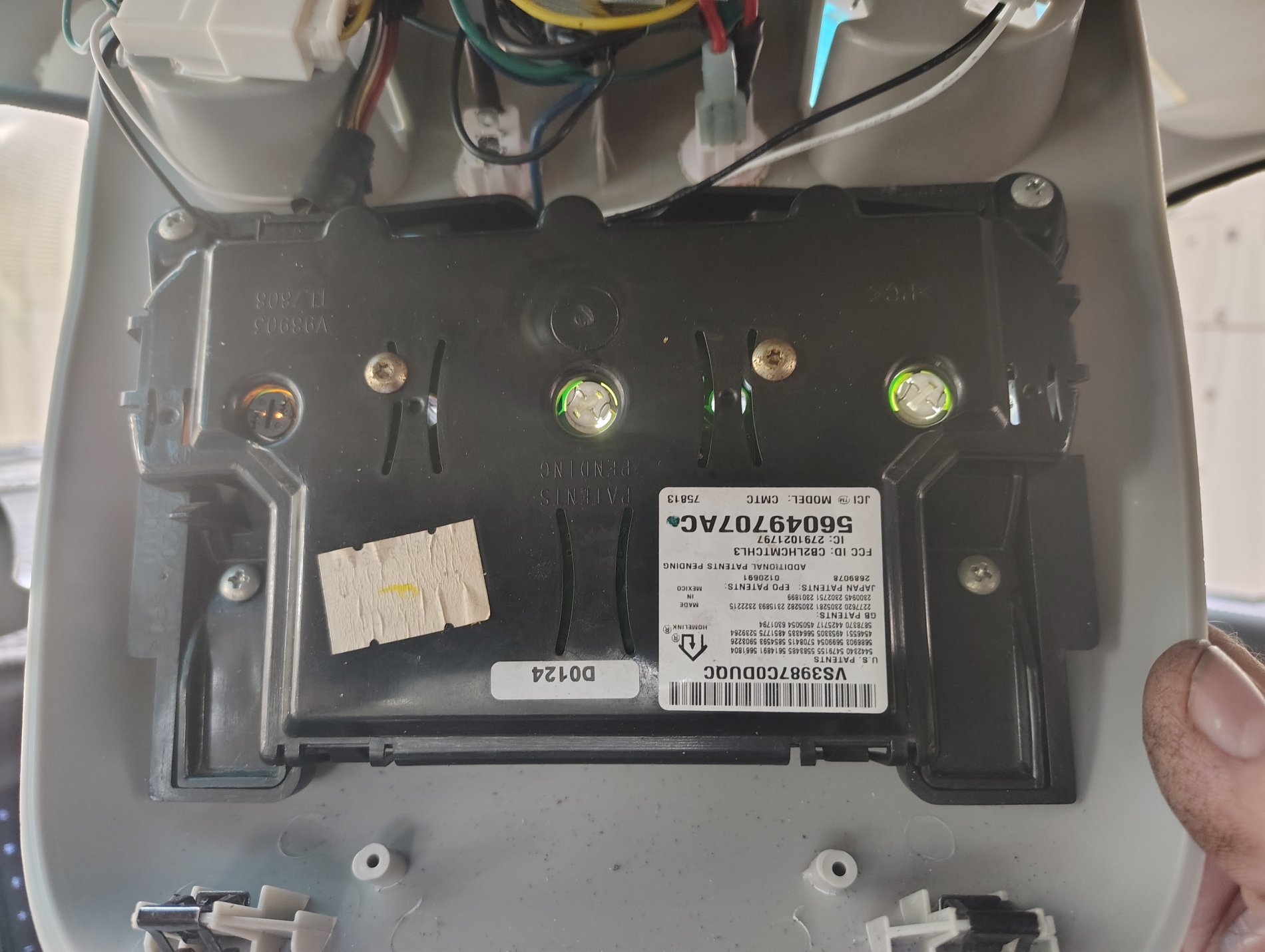

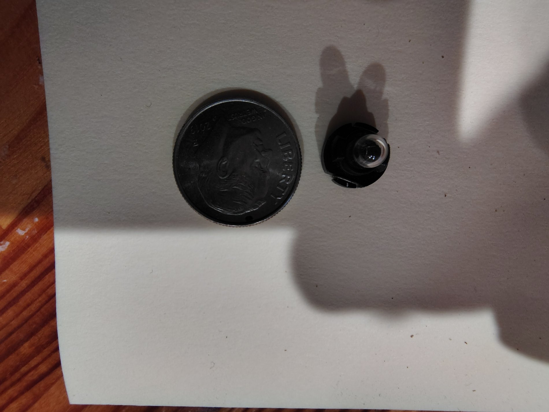

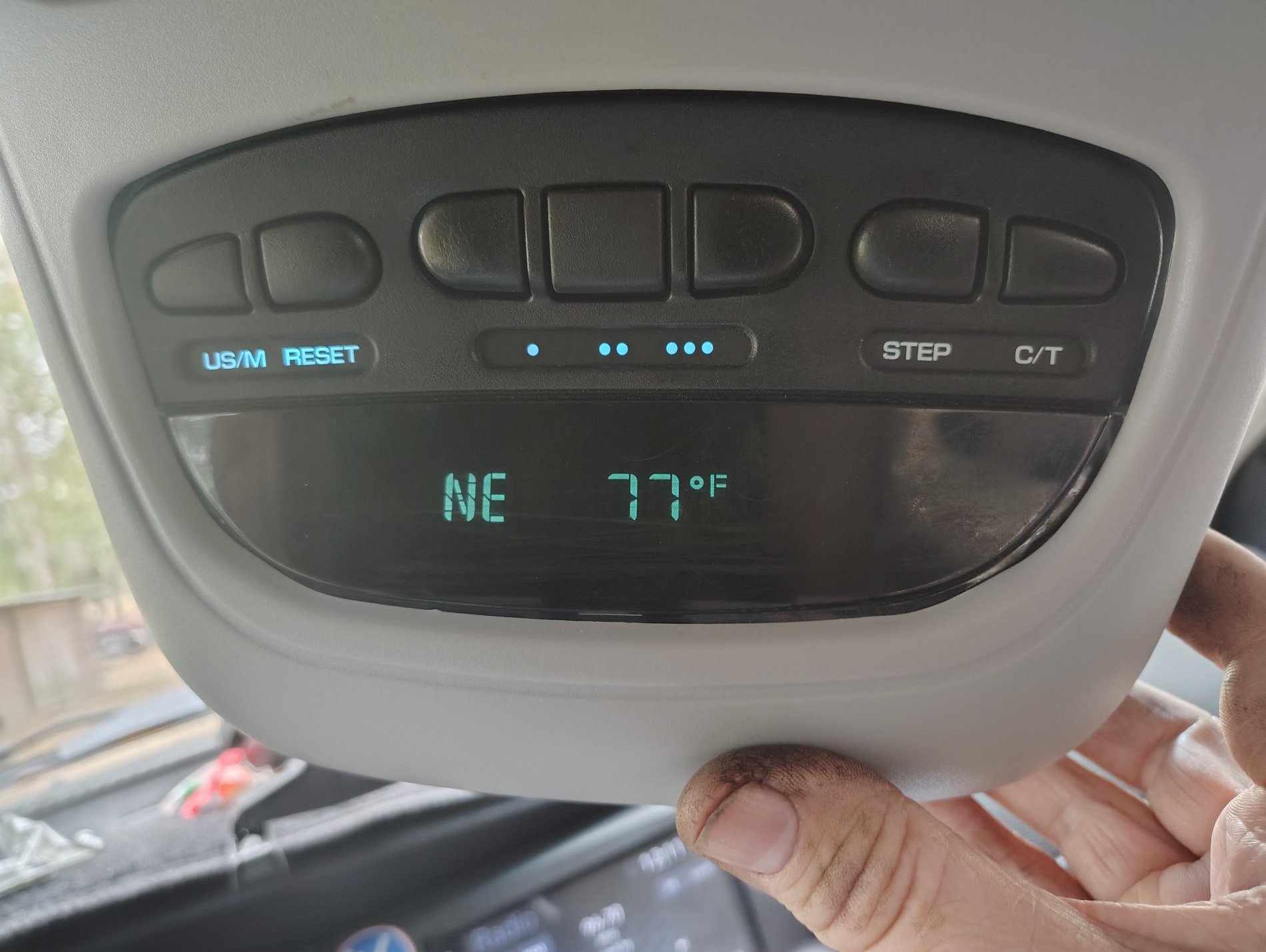

Well the t-3 bulbs came, not a great fit, but at this they work. I'm keeping the old bulbs for the sockets, might try transplanting the led bulbs from the extra t-3 bulbs. Here is some pictures.

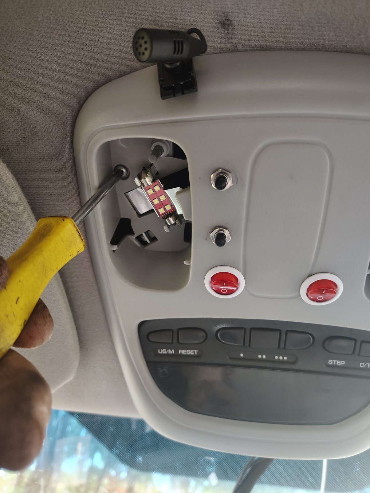

Someone asked in another thread how to take down the overhead console, I pointed out one of the two screws that hold it up, careful the light covers, lift up on the with a very small screw driver.
