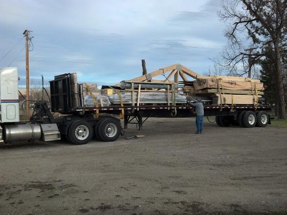

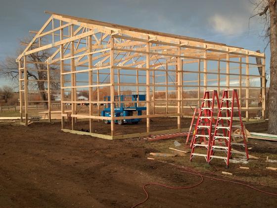

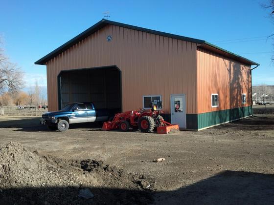

Well finally pulled the trigger and had a shop built on my property. it is a 48x42 with 16ft walls and a 20x14 door. Gonna try and trench the feed in next week if the ground isnt too frozen, then pay a small fortune for concrete.

awesome shop
nice looking shop!! how much did you spend? i am looking to do this in the future as my current building is over 40 yrs old.
I've looked at Morton for an RV barn/shop as well. How long did it take them to erect it? It's hard to tell from the pictures - is it sitting on concrete piers?

As it sits without the door it was $35K. their bid was within a 1K of Cleary or other similar shops. they buried the columns in concrete. had it built in 5 days. The crew i had building it had between 10-30yrs exp. they were very professional, cleaned up every little piece of scrap. im very happy with Morton

Good looking building! Yep, Morton is the best for a "pole" type building. Do they still have the full replacement warranty if a storm blows the building away?
You must not get much rain since there is only one downspout for the full length of gutter on the roof. :eek:

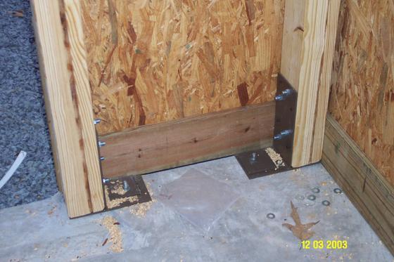

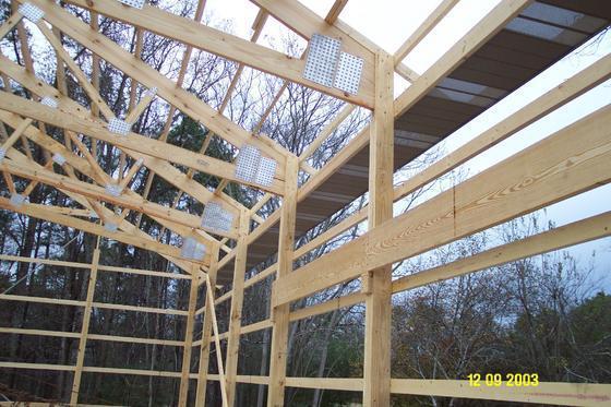

Am I correct that they "sister" the 2x6's vs having 4x6' posts? Nice job!
If I get what you mean, mine were three 2 X 6's laminated together. Prevents warping and spliiting common to regular 6 X 6 posts. This technique also allowed the trusses to sit on the shortened center 2 X 6.
