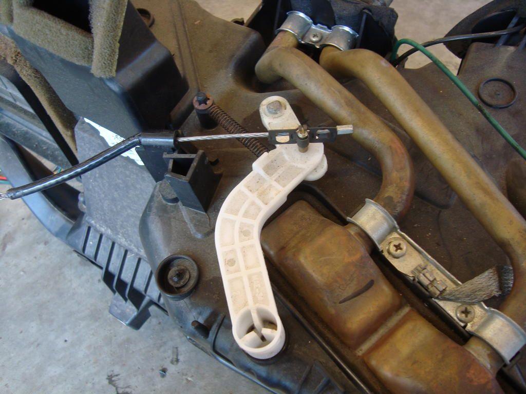

The blend door lever is above the heater core.
Pull the heater core hoses, take a garden hose and put on one side, and see how much water is coming out the other line. If not much, it's stopped up and probably corroded beyond help. If it is flowing good water, then your blend doors are broken/disconnected, and you need to look under the dash.
If I recall correctly, the stupid 98 and up trucks had an electric blend door, operated by an electric motor.... Which has a tendency to break off the arm on the door.... somebody correct me if I'm wrong. The older trucks had a cable operated door and rarely fail. But an engineer has to earn his money somewhere, making "BETTER" ideas come to life.... :mad:
I don't think it broke anything on the door but breaks the plastic coupling linking the motor to the door and the motor is in a real PIA place. There is a metal coupler available just need patience and a little Houdini moves.
