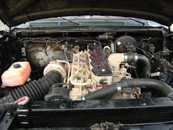

Well this was the easyist and most satifiying swap i've ever done its all bolt in every one should have one, why the factory never built one i'll never know 90 ramcharger, 92 td doner 250, banks,suncoast, = way cool ... . :D
I like it, it just makes sense. We are hoping to put a 4 cly cummins in a jeep next winter.

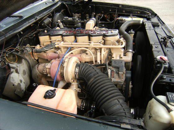

Son's is very similar, but, we went a bit further with the mods.
90 r/c originally from Iowa. (no a/c)
matched dana 60's w/discs
NP4500
South Bend single disc good up to 800lbft
NP205
'92 6bt
intercooler/radiator/AC condenser from a '96
had to get a dash from a truck that had A/C (needed vents, you know)
Since dash had to come out anyway, going w/total new instrument cluster.
That's all that's keeping 'er off the road right now. Waiting for a nicely-matched set of guages so the dashboard guy can construct the new cluster.
During the few weeks we had it at "functional, but could be nicer", it was quite a solid, reasonably quick rig.
We like your conversion, you did a very nice job. Did you bump the timing? It smooths out the engine about 60 and it gets a little better mileage. It is not a power thing but it does give the motor some pep. We like your dog too.
