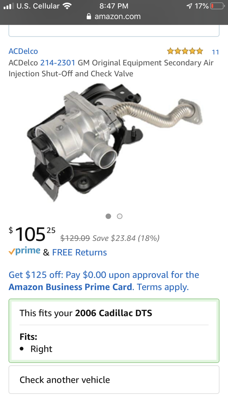

Don’t I hate a Check Engine light, no time to fix it this week..New Parts are in the trunk but doesn’t seem to be helping..!:D:D

Judging from that metal tube and flange, it probably bolts on right at a cat inlet. It’s probably up in the subframe by the rack.

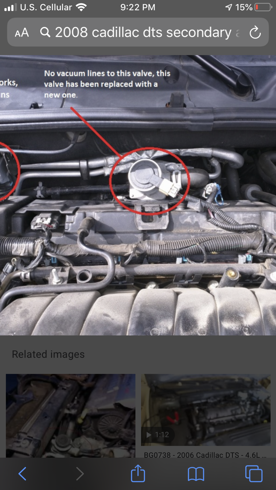

Tube goes to rear exhaust manifold. Changes from topside, just need a mirror and a telescopic magnet to bring the flange nuts up with.
Check valve has to come off to change plugs so I had it all off about 25,000 miles ago. Some people just unhook the brackets and twist it back during a plug change but that’s just asking to crack that flex tube. Removal of all is a lot better idea...
.2 book time + drill and tap when the studs let go from corrosion.
That can be the case but with both of mine that area does not seem to corrode.
Even though the connection is on the rear exhaust the nuts always start and the gasket will lift right off.
I don’t think the weasel snot gets up in there where it’s so close to the firewall.
